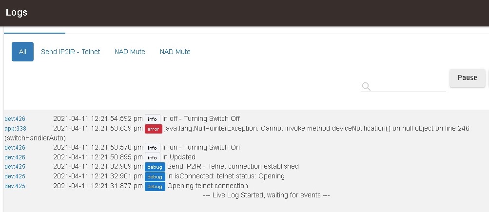

I'm trying to set up my ITach IP2IR but I'm having trouble. I can connect to my IP2IR fine but it will not fire codes from hubitat. I have included a picture of the log. Be grateful if you can give me any pointers
Show me how you're trying to send the command.

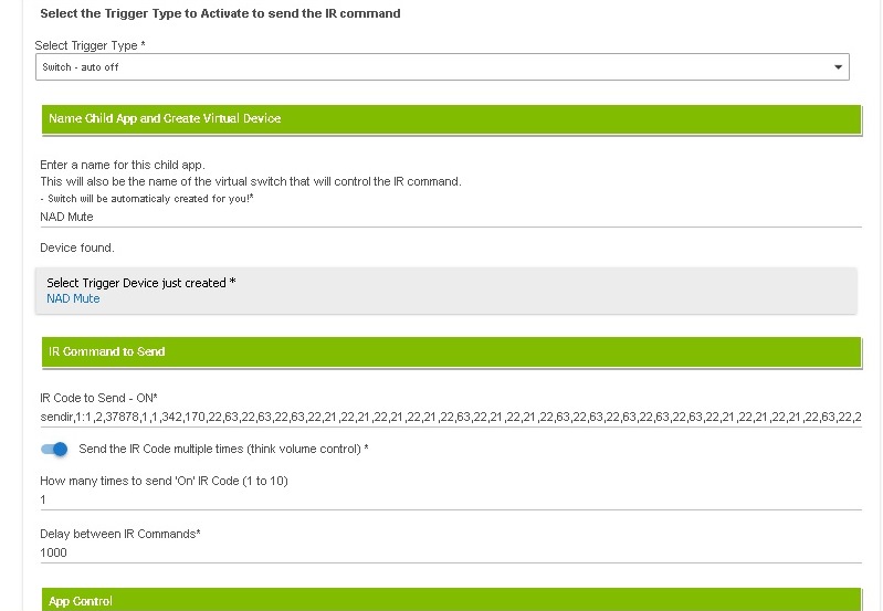

I need to see a screenshot of how you have the child app setup.
The Virtual device you choose in the Parent App is using the IP2IR Telnet driver as stated?
If you mean the actual app code itself I haven't changed that, I just installed via the package manager.
yes its using the IP2IR Telnet driver
Ok so I have worked out something. If I paste the code directly into the Send IP2IR - Telnet, Device Notification box and send the code works. So I guess it has something to do with the switch.
