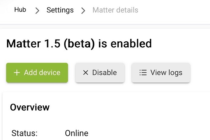

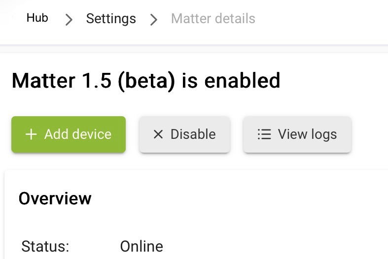

If youre not seeing the ability to add a matter device, i’d double check that matter is enabled and that you have a C5 or later hub running 2.3.8.117 or later release.
