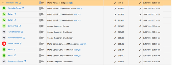

Pro Version
They are missing the Upper Button and Lower Button. Let me clarify. The outlets have hidden touch buttons, in the actual InvisOutlet App on my phone, when you go to device settings there is an option called, Touch Control, When turned on, you can touch the outlet on the left side and toggle each outlet (Upper touch button and lower touch button).
However in the app there is also a new option once you toggle Touch Control on, you now get an notion called Magic Touch and when enabled, the touch buttons no longer control the outlet, but have become push buttons, so that you can touch them and trigger things to happen. And they will not be discoverable until this is turned on in the app. I know this because when using the "Matter Advanced Bridge" that kkossev created and work with me some on the Aura version, he help find and expose them. They us the "Matter Generic Component Switch" Driver
But the Built In Driver is nicer as it already labels things correctly. and would be nice if the Upper Button and Lower Button, can be added.
Now I did notice that the Built in Driver finds the Pressure Sensor and the Matter Advanced Bridge did not

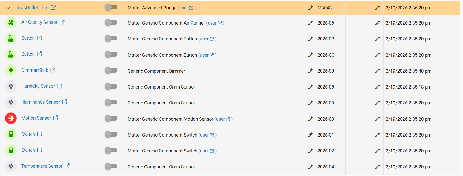

Pro Version - Using Built In Driver
Pro Version - Using the Matter Advanced Bridge

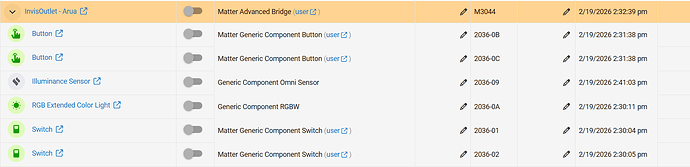

Aura Version
This is missing 1 more option then the Pro. The Aura also has the same touch buttons and if turned on in the app they also can be discovered using the Matter Advanced Bridge. (And they do function as intended).
The other thing missing that is the RGB Color Light on the bottom. That too can be discovered by the Matter Advanced Bridge. And be aware that the lights are RGB. And it uses the "Generic Component RGB" driver and that works great. (it might auto select the RGBW, so manually change it)
Aura Version - Using Built In Driver
Aura Version - Using Matter Advanced Bridge Driver
