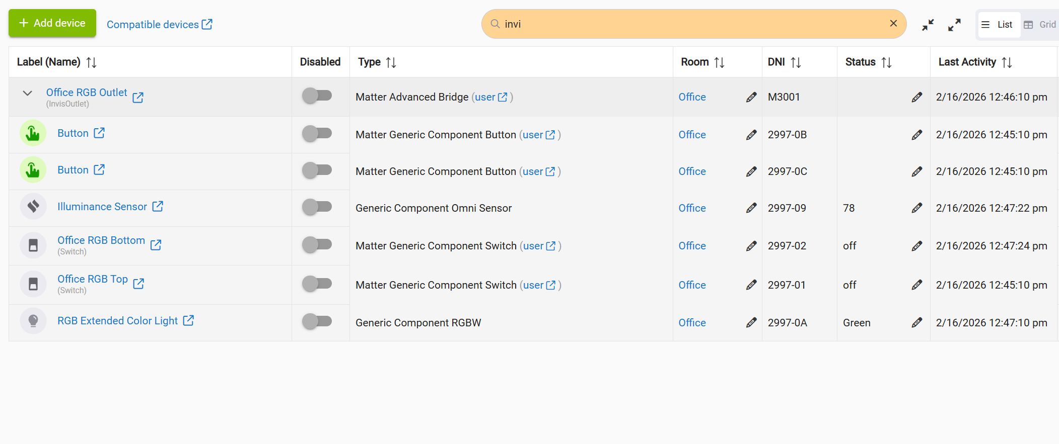

got it working now.. i actually had to physically put the front faceplate on.. i was just testing with it off and when i paired with amazon it saw the device but the advanced matter did not..
once on i reran the identify and discover and it found all kinds of devices..
side questions how is the working.. i paired it first with alexa, then generated a code to hubitat and when i paired it i used my upstairs asus wifi router in ap mode.. but i dont even have ipv6 enabled in my network so how is it working?

also i did try the stock invisioutlet driver it found the 2 switches and the illuminance, but not the rgb light control nor the 2 buttons.
