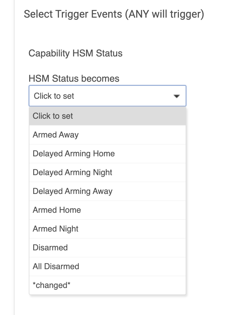

We have intentionally not introduced a lot of extra features such as this into HSM. The more features, the harder it is to use, understand, document, etc. Instead, we have made it possible to use Rule Machine as a feature extender for HSM. HSM generates events for the delayed arming states, and Rule Machine can trigger a rule from these. Then, that rule can do whatever additional notifications or sounds you might want. See below:
Ok, fair enough.
For those who come across this feature request, here is a link to a post where i was trying to build this feature in and the way to do it:
