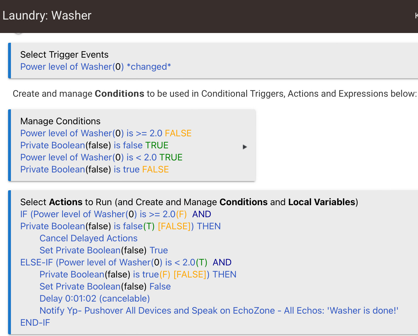

Here is my washer rule that is based on power wattage. Maybe it helps get you going. It’s been working well for several years.

Thanks for the rule! I implemented it, although I used "And Stays" instead of "Delayed Action".
I guess I'll have to test it. If what you write is true that would work well, but that would also mean I have a race-condition bug somewhere in my code (not the same code as what I replied to ritchierich about).
