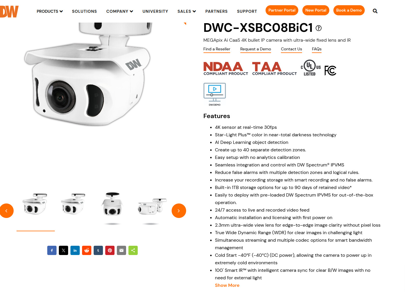

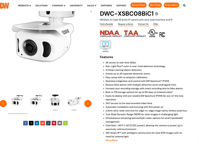

What’s the name of this AI-powered camera system?
MEGApix Ai CaaS 4K bullet IP camera with ultra-wide fixed lens and IR
Features
  • 4K sensor at real-time 30fps
  • Star-Light Plus™ color in near-total darkness technology
  • AI Deep Learning object detection
  • Create up to 40 separate detection zones.
  • Easy setup with no analytics calibration
  • Seamless integration and control with DW Spectrum® IPVMS
  • Reduce false alarms with multiple detection zones and logical rules.
  • Increase your recording storage with smart recording and no false alarms.
  • Built-in 1TB storage options for up to 90 days of retained video*
  • Easily to deploy with pre-loaded DW Spectrum IPVMS for out-of-the-box operation.
  • 24/7 access to live and recorded video feed
  • Automatic installation and licensing with first power on
  • 2.3mm ultra-wide view lens for edge-to-edge image clarity without pixel loss
  • True Wide Dynamic Range (WDR) for clear images in challenging light
  • Simultaneous streaming and multiple codec options for smart bandwidth management
  • Cold Start -40°F (-40°C) (DC power), allowing the camera to power up in extremely cold environments
  • 100' Smart IR™ with intelligent camera sync for clear B/W images with no need for external light
    [Show Less](javascript:)
  • Smart DNR™ 3D digital noise reduction reduces noise and ghosting for motion in low-light environments.
  • Two-way audio for direct communication between the monitoring station and the camera's location
  • Alarm sensor input and relay output for access control integration
  • Web server built-in for easy camera management from any browser
  • PoE and DC12V for single cable simplified installation
  • NDAA/TAA compliant for federal and government projects
  • IP67- and IK9-rated camera housing built to last
  • 5 year warranty
DWC-XSBC08BiC1
It is pre-loaded with remote view (NVR storage on Camera). Also the AI app is onboard as well. It is a very self contained commercial camera. Kind of unique
Looks nice. Must be pretty expensive to get all those features on the camera.
