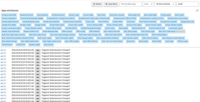

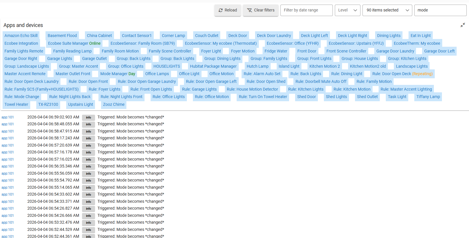

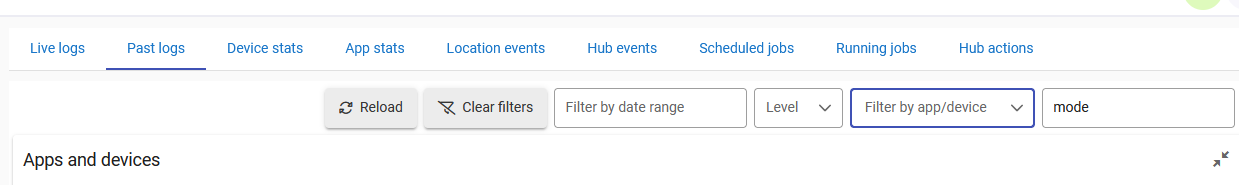

First, I used the search option in the logs -

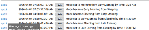

Then I drilled down by selecting the related app number on the left.

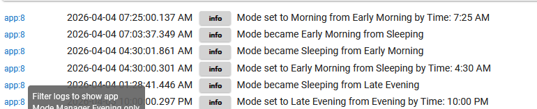

In my case it's 'app: 8':
Appreciate the feedback. Yes, searching for mode does yield some results, but I do not see anywhere when mode is changed and what triggered it. I only see apps that affected by a mode change. In your logs, what is app:8? I have nothing in my logs similar. Mine are all just the apps that are triggered.
As I understand it, when an app is enabled or added to your HE environment it is assigned an ID number. Like for devices, this is a foundational component. Names and labels (for devices) associate with this.

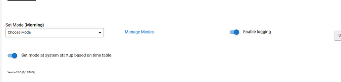

Unlike devices, there isn't a lot of optional logging options : just this at the bottom of the app page:

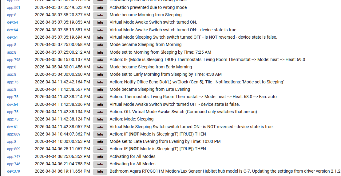

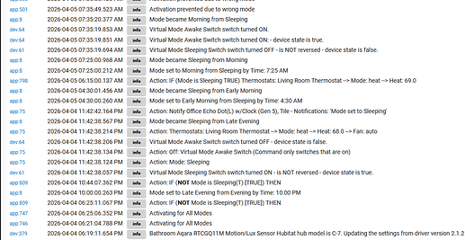

Mode changes in my environment are visible if I've set OTHER apps to trap the logging. Heres a result from this morning showing apps doing their business - 5 lines from the bottom you can see the Time 10PM triggered as well as a few other events throughout the night into early morning :

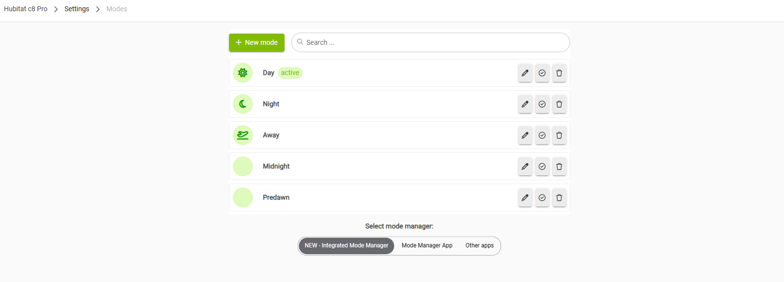

I think that in the definition of Modes (which is still hidden in the Settings kind of legacy like) one shouldn't have 'state' modes. However, in my case I still have them but don't use them:
Also note that in the mode definitions on Modes (see above bottom of screencap) there is a 'select Mode Manager' and a 'NEW - Integrated Mode Manager' option exists. I have never tried it so I can't say if that may be helpful to you or not. YMMV.
