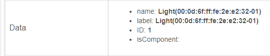

You can use any number of named ‘data’ values, which are a per device set of stored values .. I use them for extra MQTT info like the associated topics and attribute mappings

I haven't looked at the code yet.. but it seems the level on deConz is updating bri (not level) and using setLevel updates level but doesn't propogate to deConz ?
Yes I just realize that I have to do the other conversion ones bri come from deCONZ need to update the level value too working on something else now I will get it later
