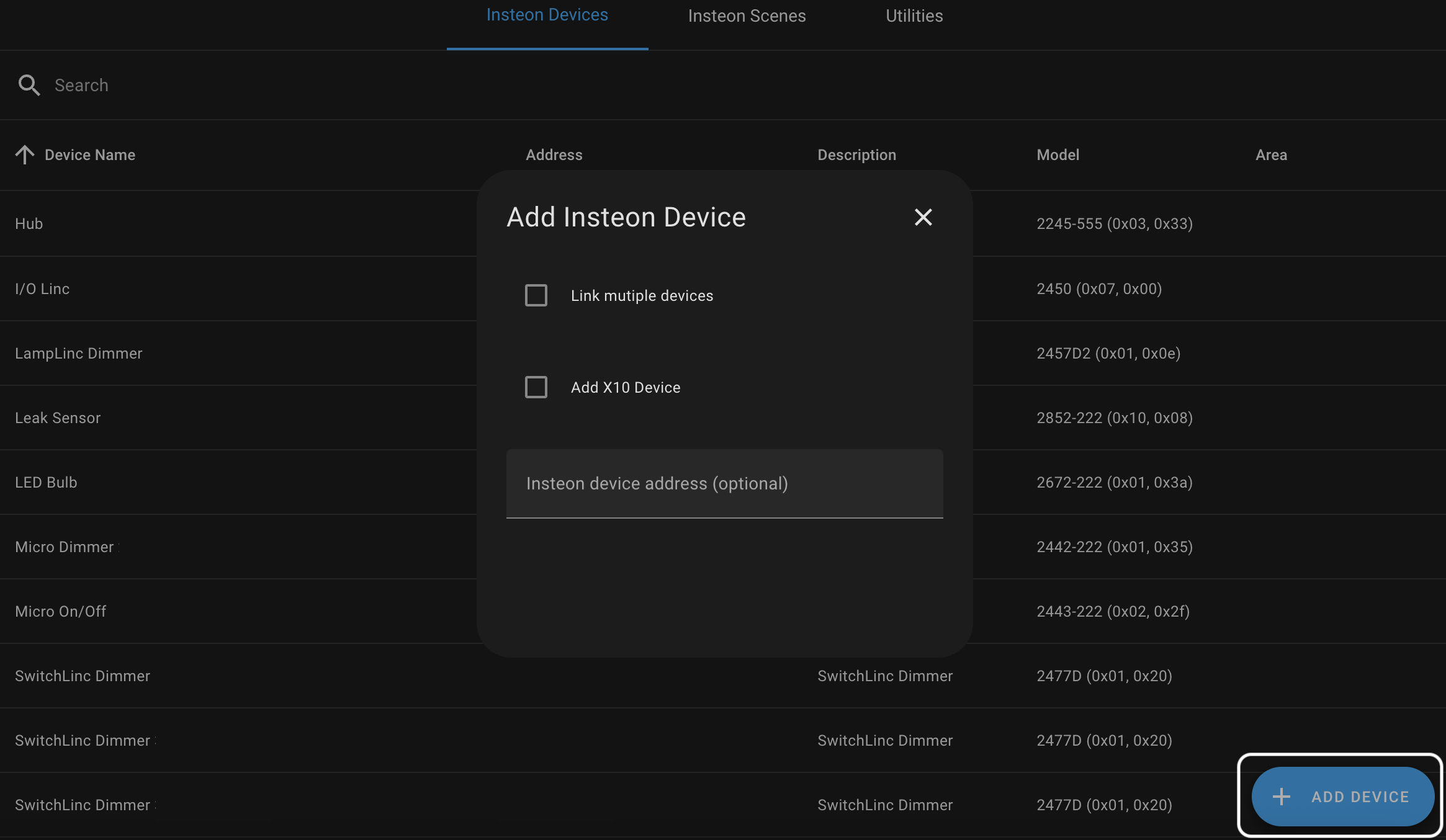

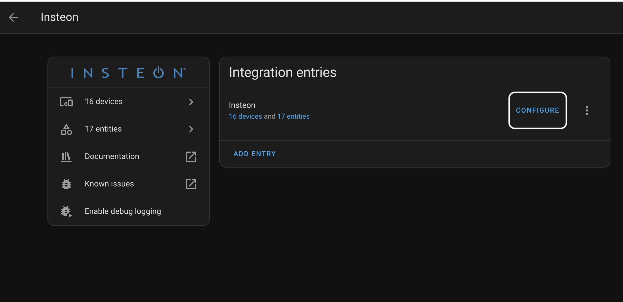

I recently spun up a HA docker image and enabled the Insteon hub integrations. 11 or my 20 leak sensors are trickling in...but I don't see a way to add new (leak sensor) devices to the Insteon hub.
  1. Open the integration and click Configure
  1. Click on the Add Device button, and enter the device address of your leak sensor.
Be patient. The add device function is not fast, nor is the listing of the devices as you have already noted.

I tried this:
  1. Navigated to the 'Add Insteon Device' prompt
  2. Entered the leak sensor device address
  3. Held down the button on the leak sensor until the green light started blinking
  4. Pressed the correct (hidden) button
  5. The 'Adding Insteon Device' prompt appeared
  6. I heard the two beeps from the hub
  7. Patiently waited for the 'All-Linking is complete' prompt
but I don't see the new leak sensor in the Insteon Devices list.
Am I doing something wrong?
