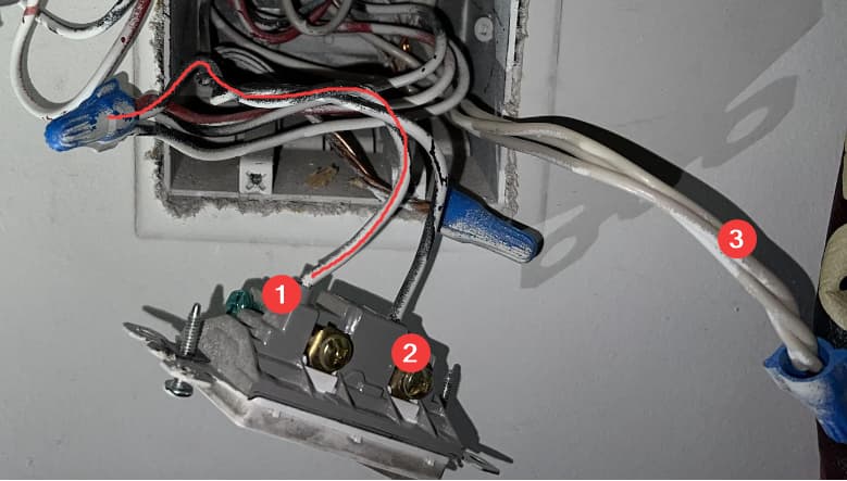

I have some Zooz switches to install and I know their support is really great for this. But I also want to have a bit more comfort/understanding myself. Frankly, I think it’s mostly just overwhelming and I don’t want to get electrocuted, so breaker is off.
I have a “simple” box like this with all the needed wiring:
https://imgur.com/a/2HNAN8Z
Left is on a 3way right is single pole. Even switching out the single pole, I need to bring in the neutral which I THINK means I can just tap into the bundle of white wires?
but for the two connected wires how do I actually identify which is for line and load? And be certain about it? Their manual says these can’t be switched I assume it risks breaking/frying the switch…
All the Black wires are bundled and that's most likely to be Hot/Line. A black wire in that bundle goes to each switch. Put that wire into the Zooz Line connection. What's left over is Load. :slight_smile:
I'd suggest wiring up the Zooz and leave what you imagine is Load unconnected. If you have it wrong, the LEDs on the Zooz won't have power because you used the Load wire... so nothing will fry.
Obviously you should cap (wirenut) the unconnected wire during this test to prevent accidents.
The best my eyes can do with the pic is say that I think the left wirenut is hot/line.
For the switch on the left, you have one hot (black) and two Travelers (red and white).

Yeah the left I’ll have to double check the final wiring because it will be a 3way on zen76 and I know the wiring gets slightly more complicated for that.
For the right, indeed the bottom one goes to that bundle and the other goes straight to that conduit in the top left of the box. So it certainly seems you’re right (I wasn’t aware the bundle typically indicated the line but that makes sense understanding it a bit better…)

I think as @csteele explained (1) should be the line, and (2) is load, that is, if I traced the wired back to the bundle correctly. For (3) you can just add a new piece of jumper wire to the bundle for the neutral (you may need a larger wire nut).
If you post pictures of both sides of the 3-way I can mark that one up also.
