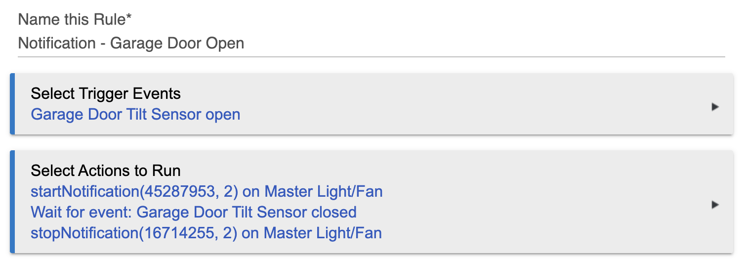

So I got a new garage door, put on a new (much more reliable) tilt sensor.
I came back to this thread to try and fix/make this notification system on my Innovelli switch work.
BUT NOW NOTHING IS WORKING!! As soon as I open the garage door, the sensor correctly changes from "closed" to "open" and yet... the Switch Notification does not change at all!! Before it would start to work and then I just had issues reseting it, which is what I thought I would have been working on tonight, but instead now I can't even get the initial DOOR OPEN NOTIFICATION!
Any ideas??
Here is the current rule I was going to test...
There are two things you could do to narrow down the problem:
Turn on (at least) "Trigger" and "Action" logging for the rule above. This will show you what the rule thinks it's doing and when. It's possible (though unlikely IMHO) that the rule is not triggering, thus causing your problems. In that case, just going into the rule and hitting "Done" may help re-initialize things. (Check the "Logs" page if you're not sure where to find the results of your efforts here.)
Try the
startNotification()
command directly on your "Master Light/Fan" device from its device page, using the same two parameters you provided above. If it does not work on that page, it definitely wont' work in a rule (or any app), and you've narrowed it down to a problem with the device or command.
