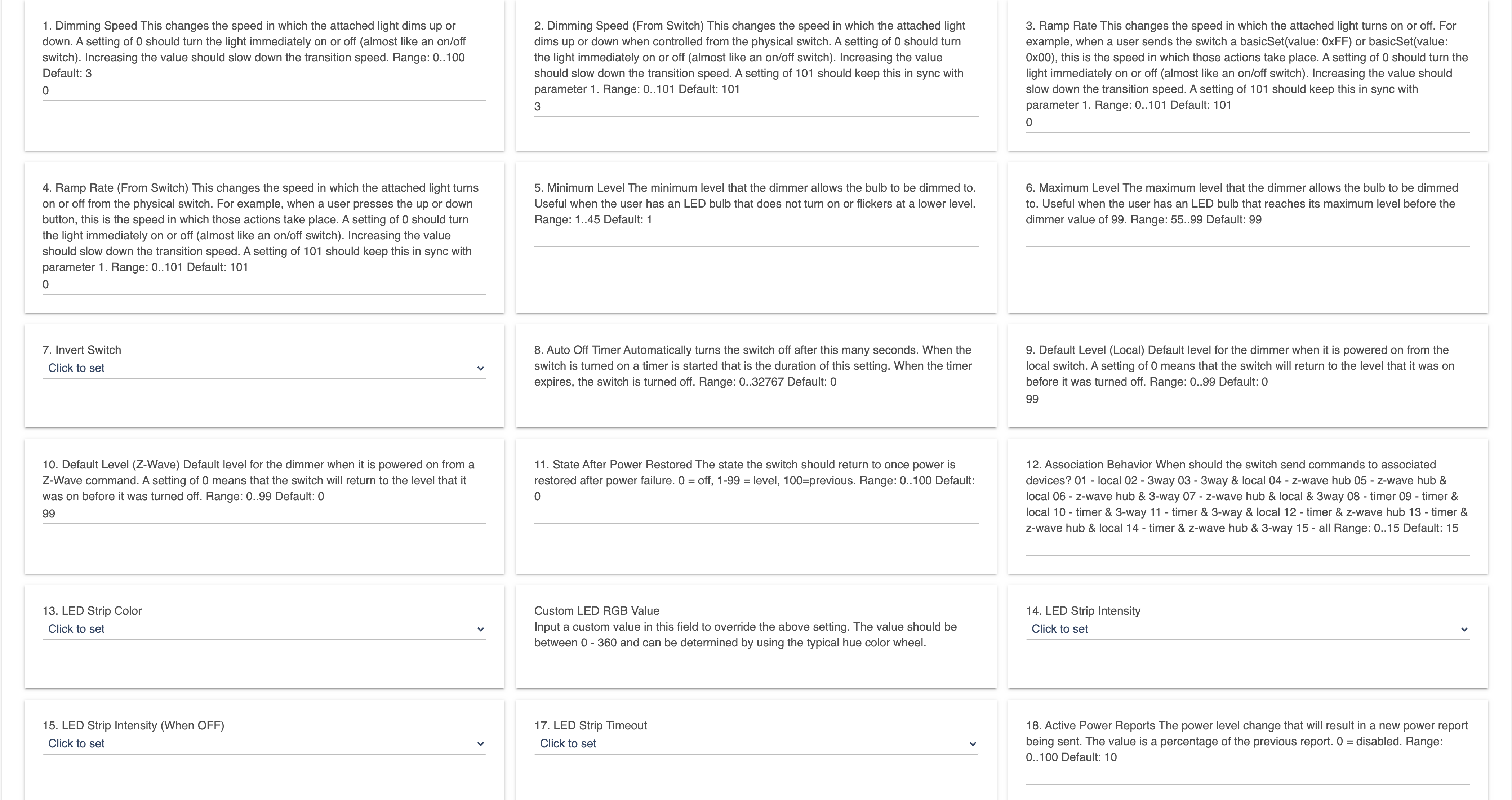

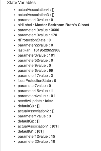

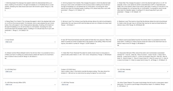

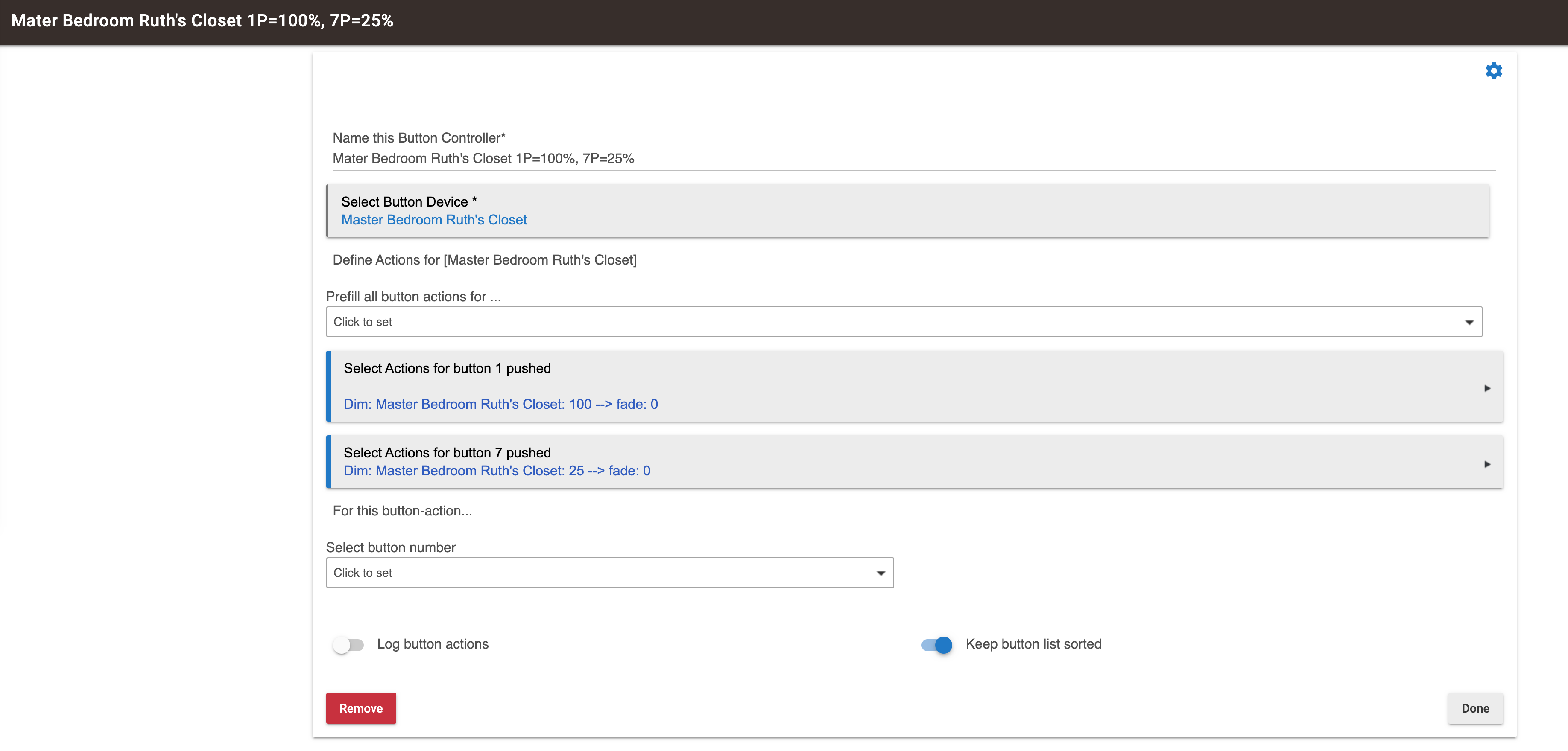

To accomplish the first two I create 2 Button Controller rules: the first one says that a button 1 push "fades" the dimmer to 100% over 0 seconds and the second rule says that a button 7 push fades the dimmer to X% over zero seconds. To have the light come on as fast as possible from either a rule or physical push I set params 1, 3 and 4 to zero and param 51 (disable physical delay) to yes.
I set param 2 to 3 to be able to dim the light from the switch. I found that if I set it lower the commands are sent before the light reacts so I over or under shoot what I want. But that should be irrelevant here. I also set params 9 and 10 to 99 as I like the light to come on fully bright if off, but again, should be irrelevant here.

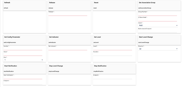

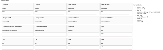

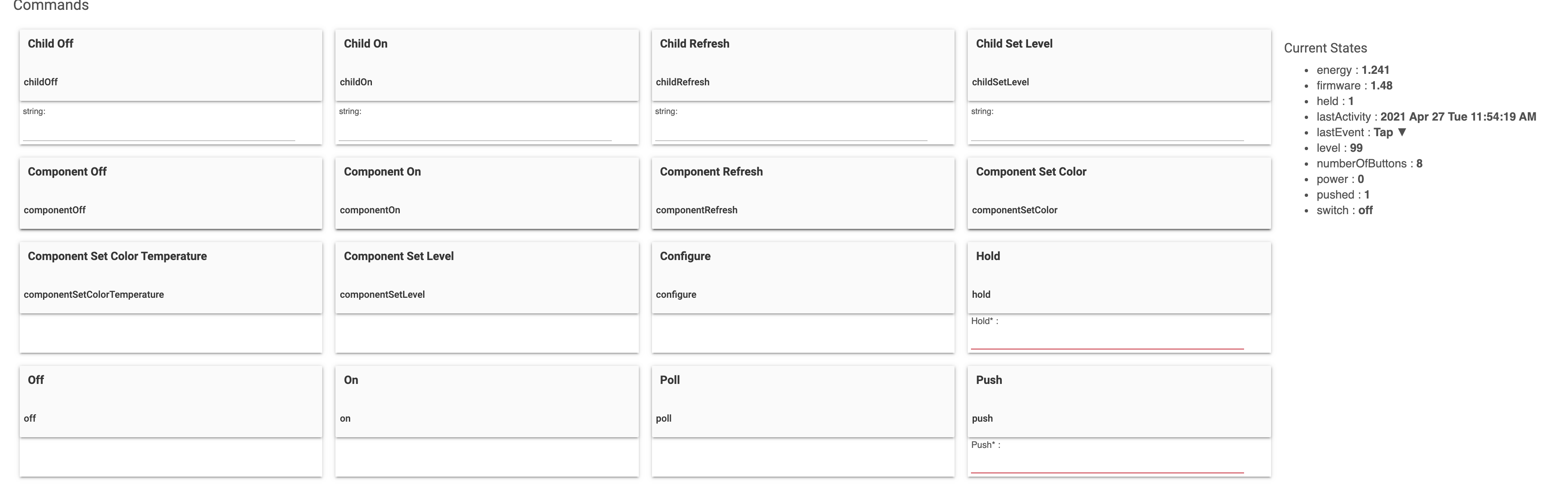

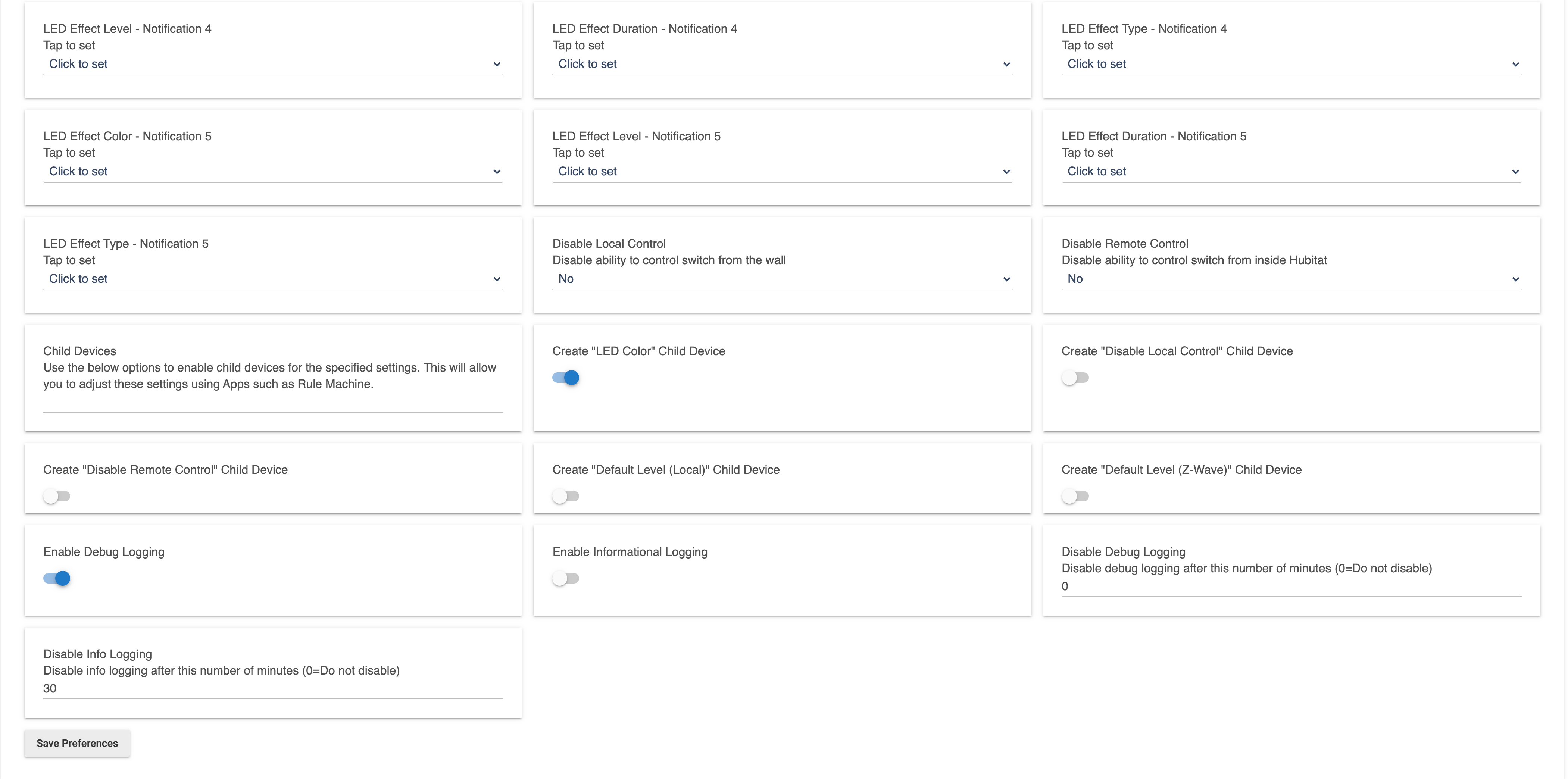

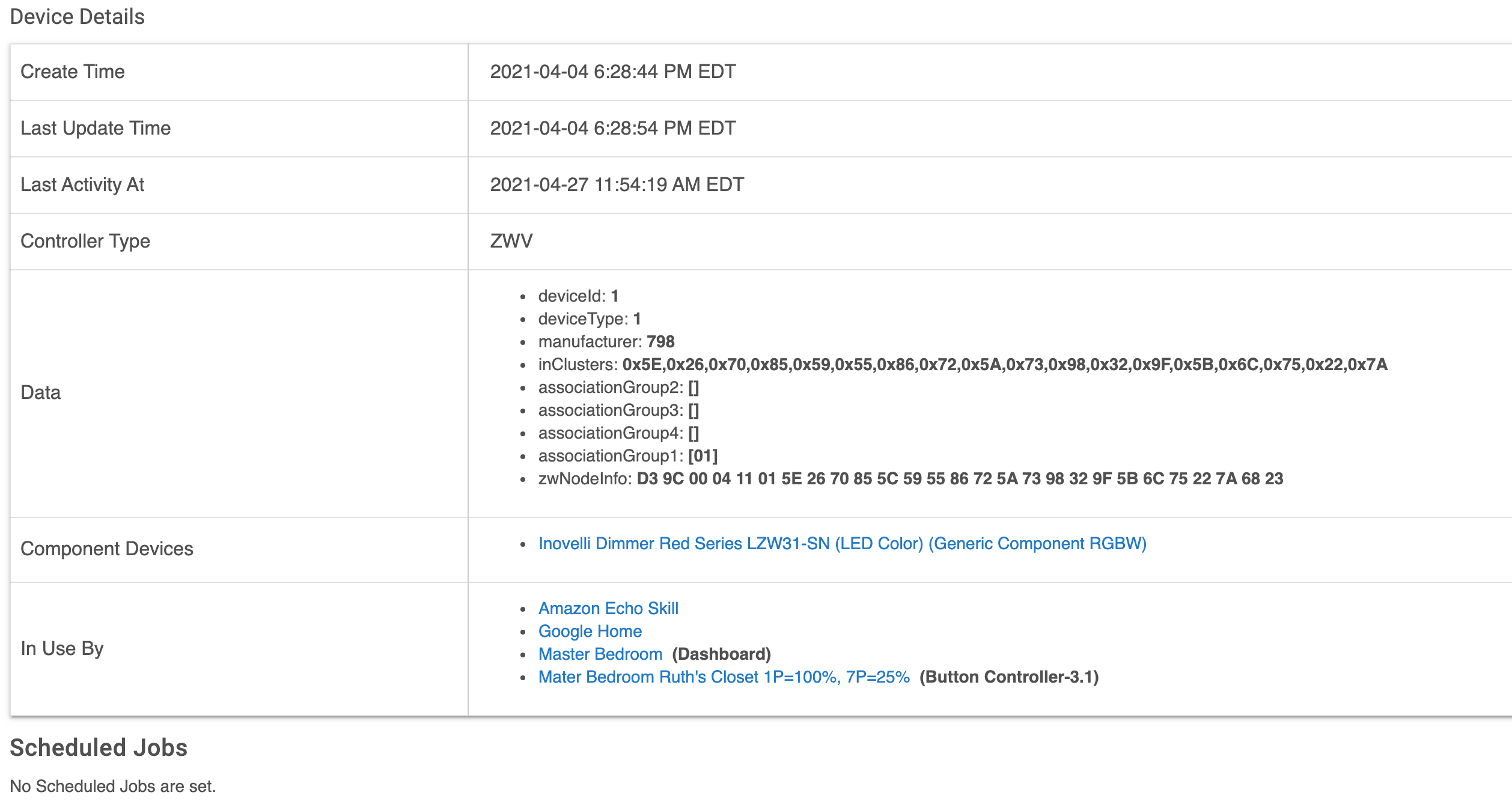

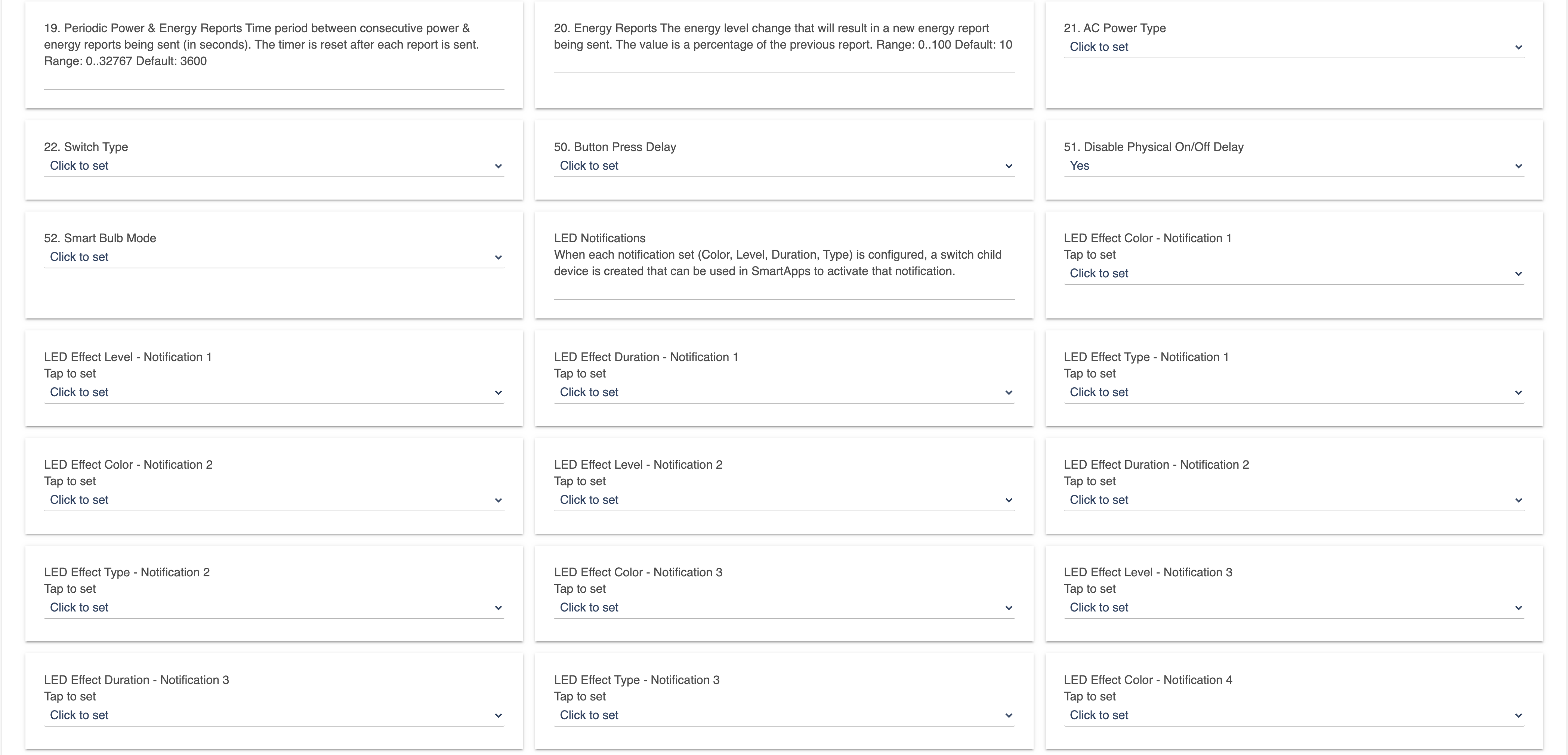

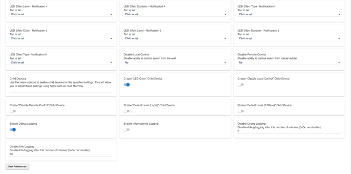

That works for every switch but one. For some reason, even with that exact same setup for multiple switches they all come on/turn off almost instantly, except one switch which fades on and fades off. I doubled checked to be sure that switch isn't in any other rules that might be messing it up. (I'll post screen shots below of the device setting and Button Controller rules). Anyone have any idea why this one is behaving differently? (I'm thinking/hoping I just set something wrong and I'm just not seeing it).
