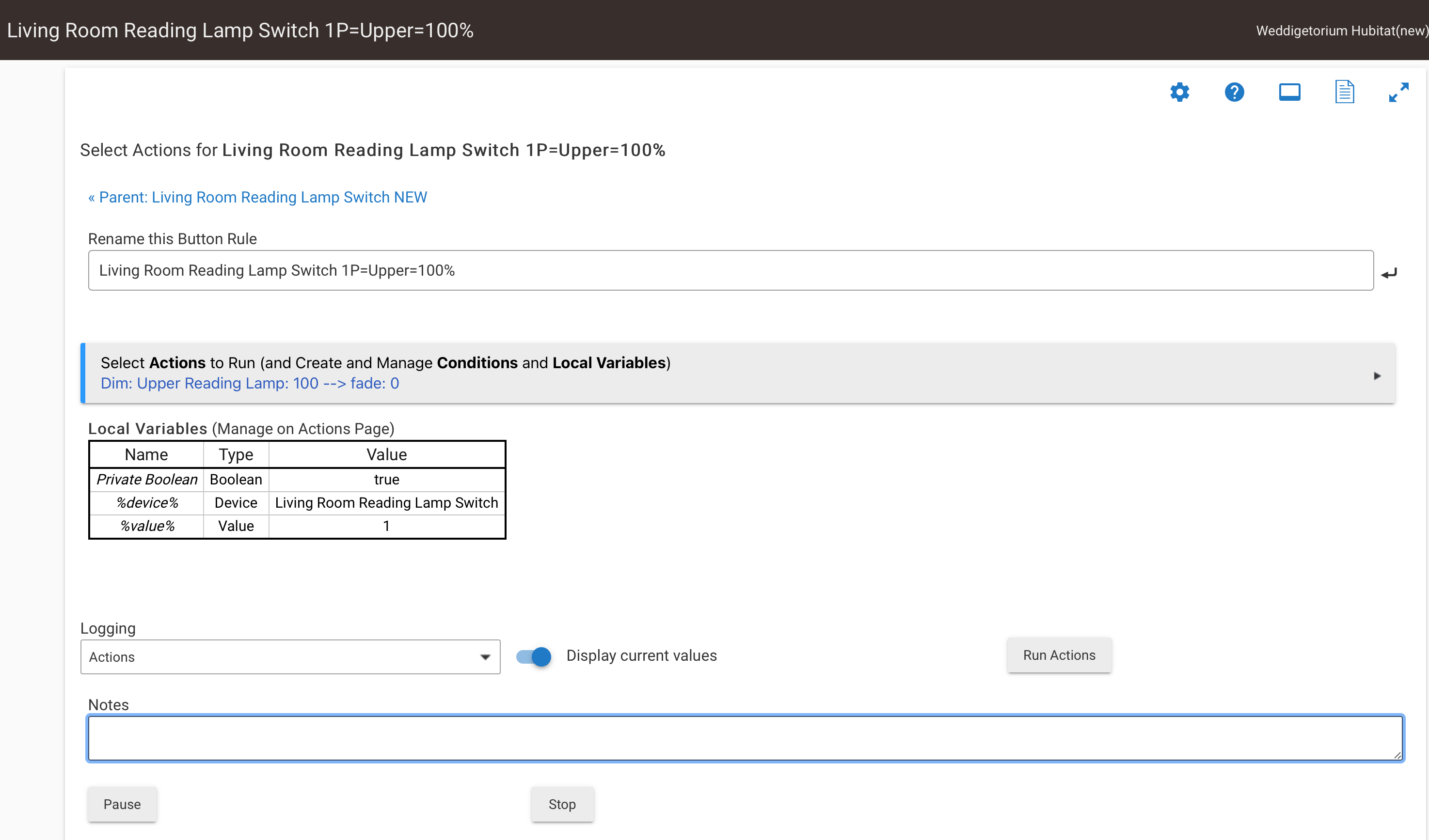

Switch on:
Switch off:
I made sure that both the Living Room Reading Lamp Switch and the Upper Reading Lamp are only being used by these rules:
Here is the Living Room Reading Lamp Switch
and here is the Upper Reading Lamp:

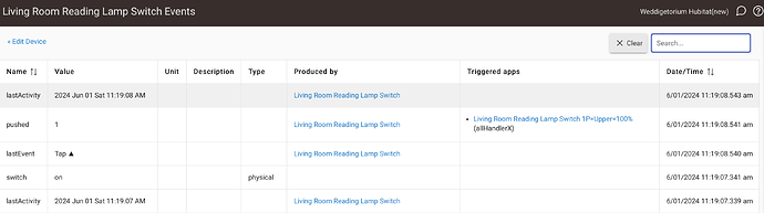

Here are the event logs:
This is the Upper Readings Lamp when I turned it on and off from the app:
and here is the event logs for the Living Room Reading Lamp Switch with me turning it on and off from the switch itself:
Any ideas on why the LED is turning off?

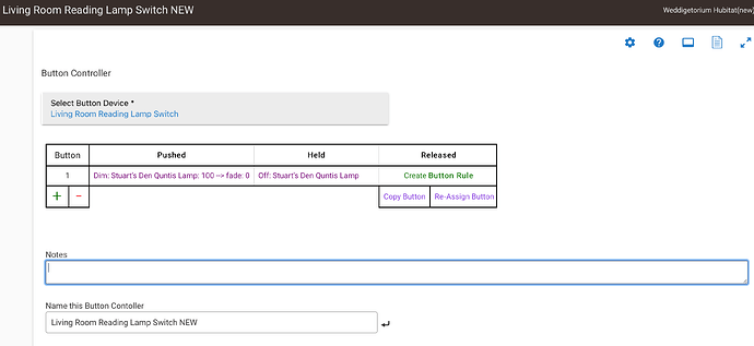

I also created another test rule where one swtich does nothing but turn on the Living Room Reading Lamp Switch and the same thing happened: the LED came on and when turned off after a couple of seconds:

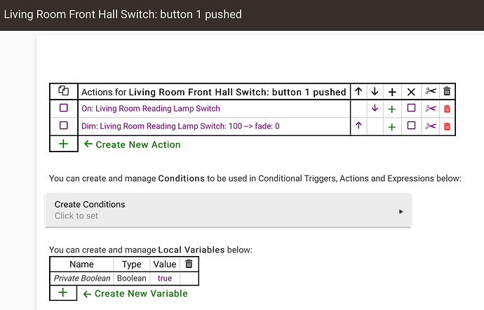

I also went in modified that to 1st explicitly turn on the Living Room Front Hall Switch in addition to "dimming" it to 100% and that made no difference:
To even isolate it from the Hue bulbs I change the rule for the Living Room Front Hall Swithc itself so that it turned on a different light instead of one of the Hue bulbs, to no avail. About 4 seconds after the LED goes to 100 it turns off:
