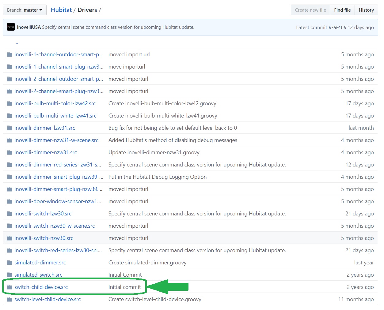

Have you installed the "child-devices" that is required?
Once you have the "child-devices" running you should see something like this.
