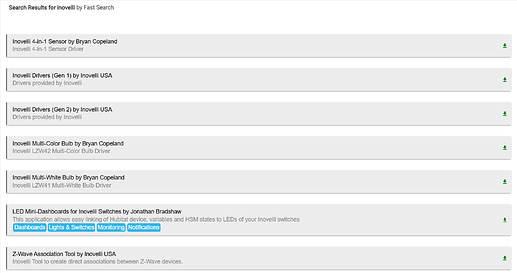

A quick search for Inovelli returned this.
Both of the drivers you need can be chosen from the Gen 2 selection.
