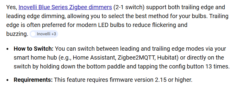

I don't have any of these but aren't they capable or leading edge and trailing edge dimming? If so you might want to try each way and see if one behaves better. Trailing edge is supposed to be better for LED bulbs.

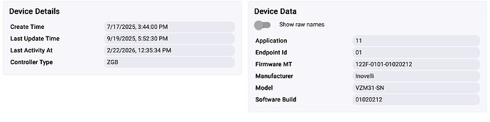

I just found this, but it doesn't seem to provide a firmware edition number.
That's firmware 2.18 (source).

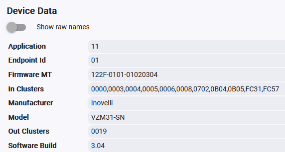

You can update a zigbee device if Hubitat has the update file from the manufacturer and has posted it. I updated all my Blues to 3.04 a while ago, so it should still be available now.
Open the live logs page in a new tab. Click the "Update Firmware - Run" button on the Blue's Commands tab page, and then watch the update progress in the live logs.
For some of my Inovelli Blues, the update to 3.04 took several tries. But I've updated over 50 switch/dimmers now. Once you update, you should see this:

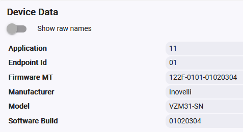

EDIT: HOWEVER, after you update, if you (1) select Driver as Type and Save, (2) go to Commands and click on EVERY "Delete All ..." button, and (3) change the driver back to "Inovelli Dimmer 2-in-1 Blue Series VZM31-SN" and Save, then you should see this:
I figured out how to run the updates and the logs show that everything "took".
