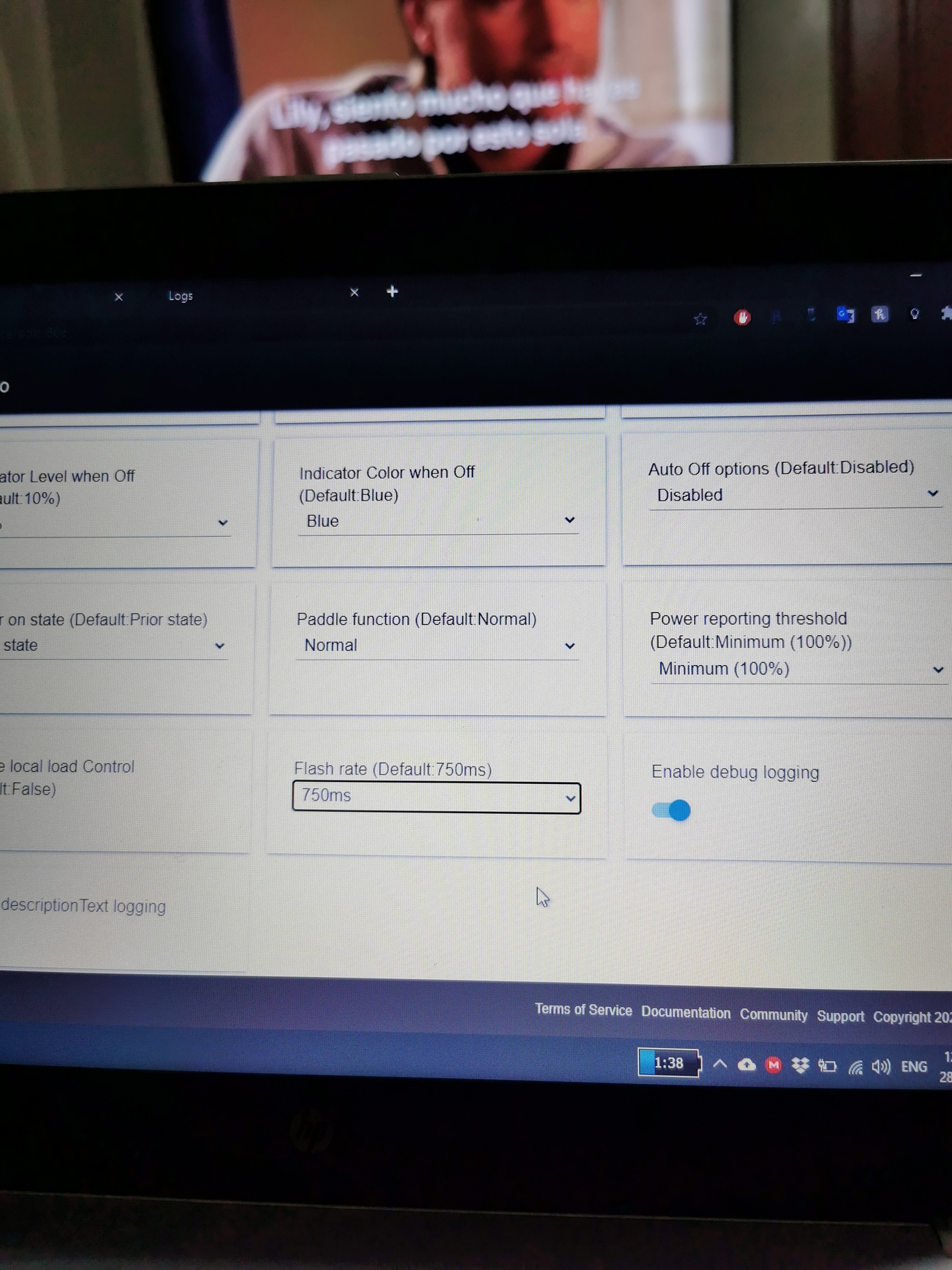

That one? The flash rate?
On the configuration page for the parent device "Disable Physical On/Off Delay":
Screenshot_20200827_211243
This requires firmware 1.36, and current drivers.
