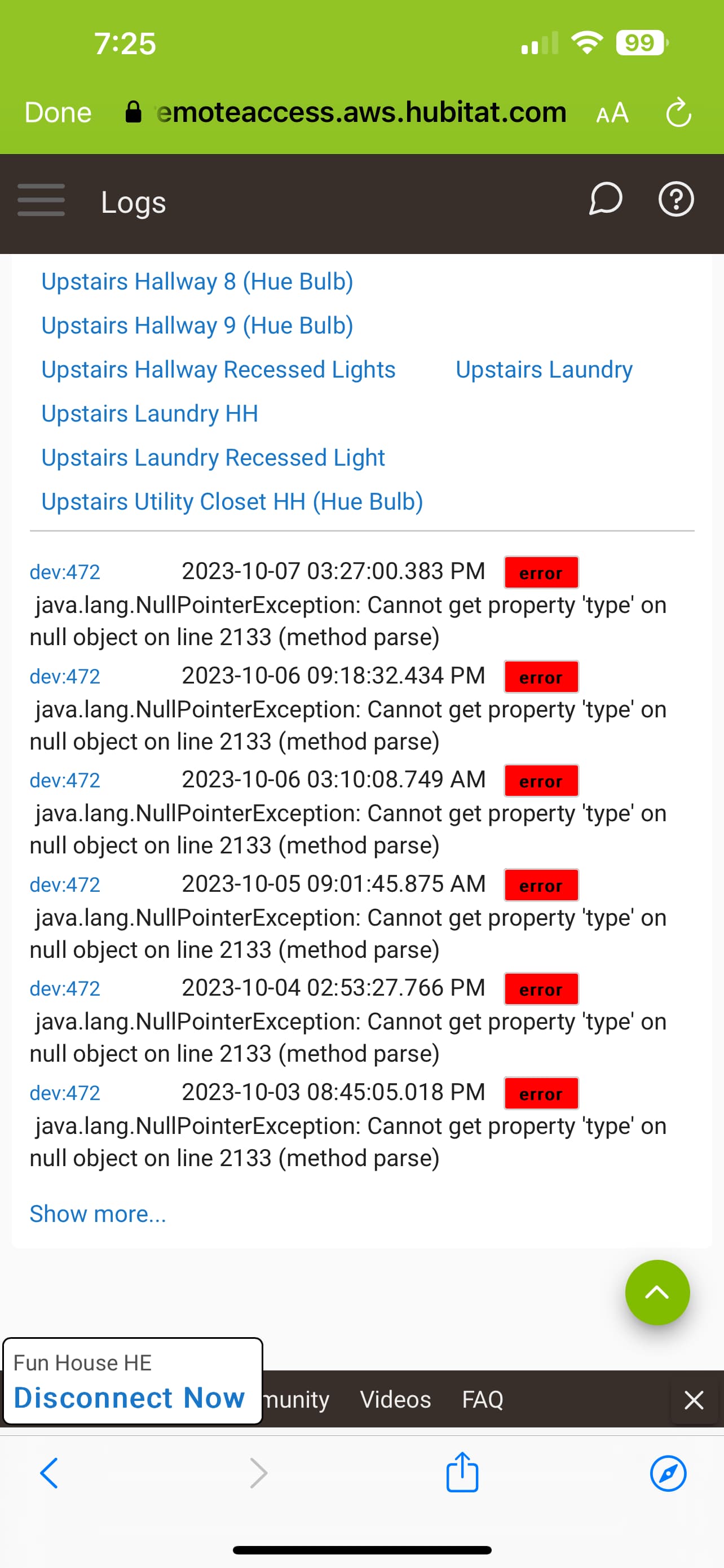

I see this error line in all of my inovelli switches. This is an example. Can someone explain it to me and a possible correction

Clicked configure button
Look at live logs now and see if the errors persist

This is fixed in the latest driver but it hasn’t made it into HPM yet. Hopefully @ericm can update HPM in the next few days
Thanks @mark.amber! Out of curiosity, will that be the 09-14 version or will it be something newer?
@hydro311 The latest is 10-01 but the ‘fix’ for this error was 08-23 I believe. So it should be included in 09-14 if that’s what you’re running

I forgot to answer this question. The error was due to a new firmware feature that the older driver didn’t know about.
The new firmware (and new driver) now reports the switch internal temperature and can be used to detect if the switch is overloaded
