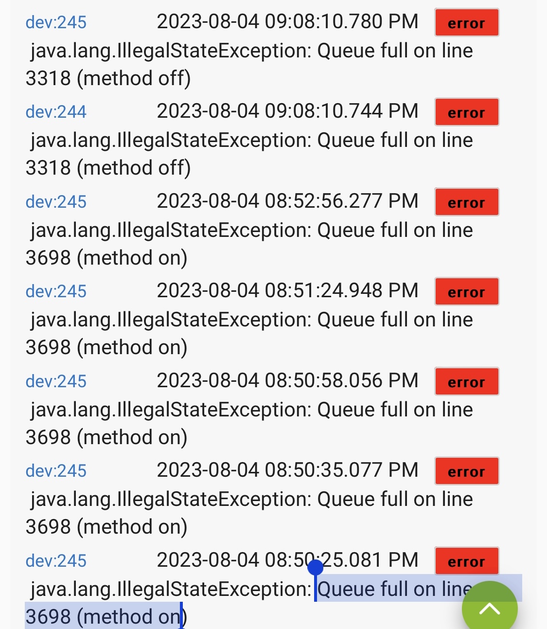

Anyone with the inovelli blue dimmers see this after the latest HPM update?
How do I fix it? What’s on line 3698?

This is not a bug, your Zigbee's queue is full. If you have many Blue switches I suggest disabling the power and energy reporting, or making sure the power/energy reports are not flooding your Zigbee radio.
On it thanks!
You may need to power cycle your hub by shutting it down from Settings, then unplugging it for a minute to clear the queue.
