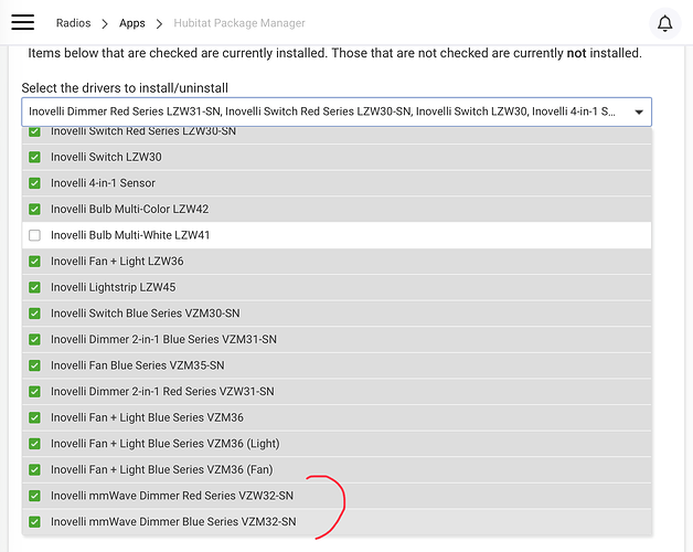

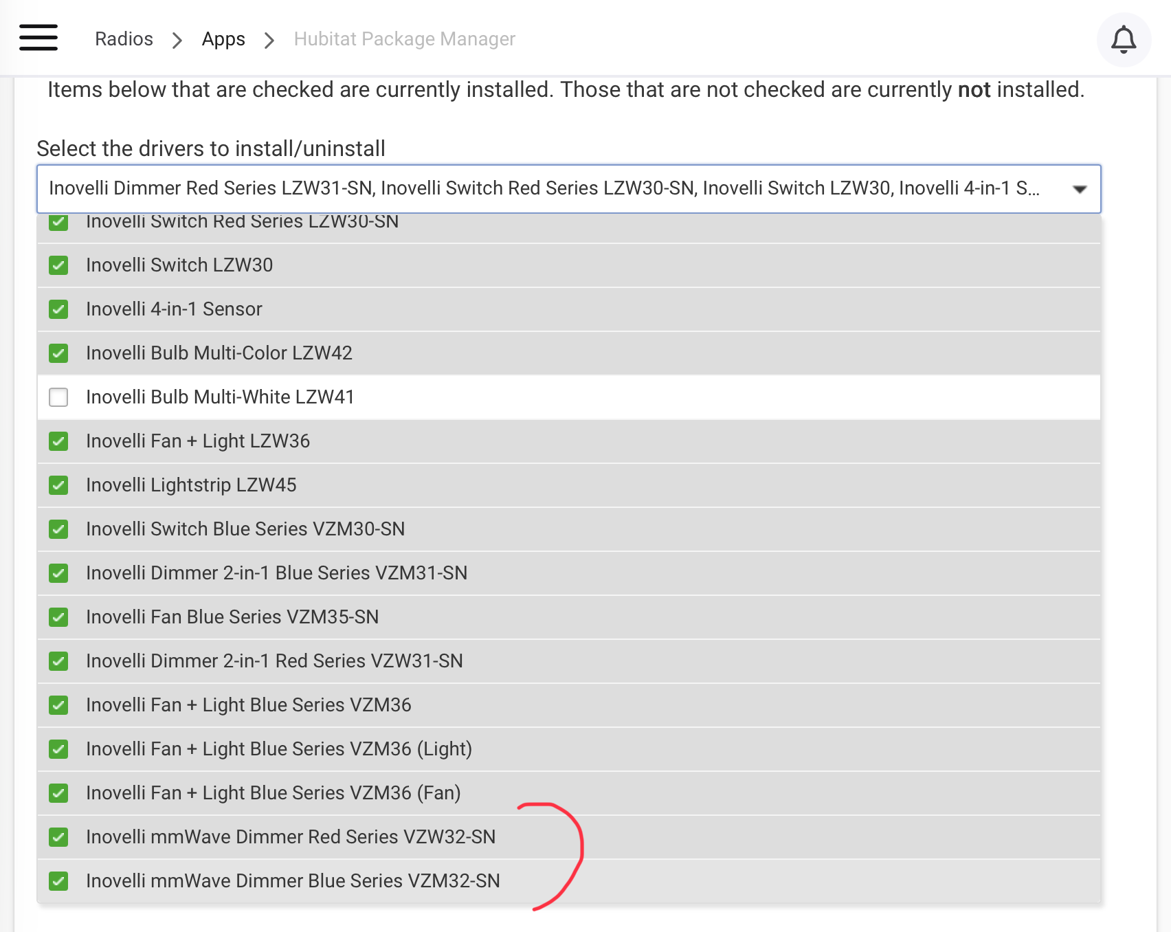

They have their driver here:

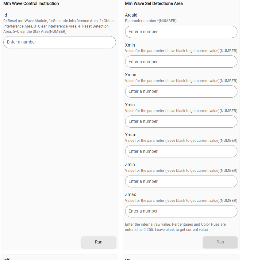

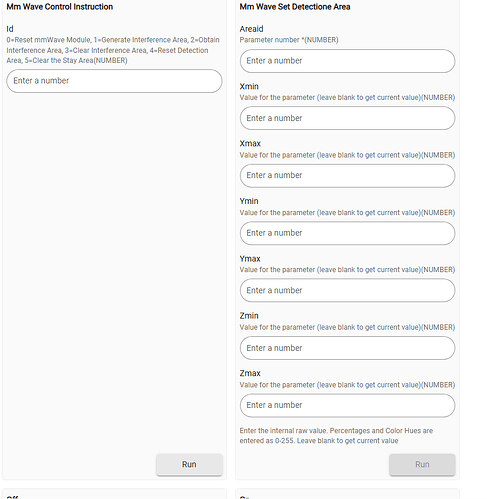

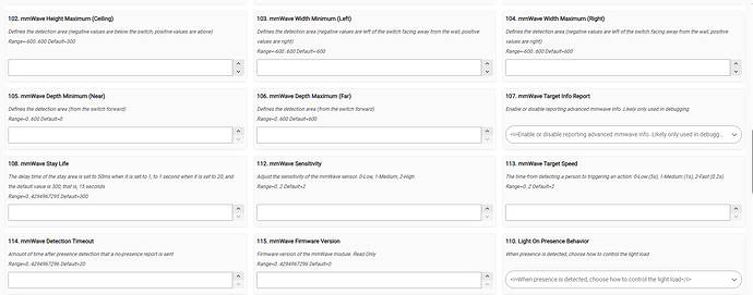

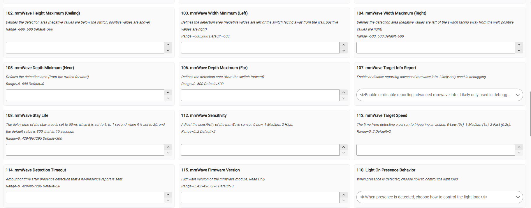

I looked at the Inovelli mmWave Dimmer Blue Series VZM32-SN driver; it has a ton of commands and options for fine tuning the mmWave module (much more than any other mmWave sensor I have seen) :
There is a rather detailed documentation available online :
All these advanced tuning parameters have properly selected default values. For a quick start, you shouldn't adjust themâthe mmWave module should report motion as active or inactive right out of the box.
Observe the Current States: motion attribute. Does it change between active / inactive?
