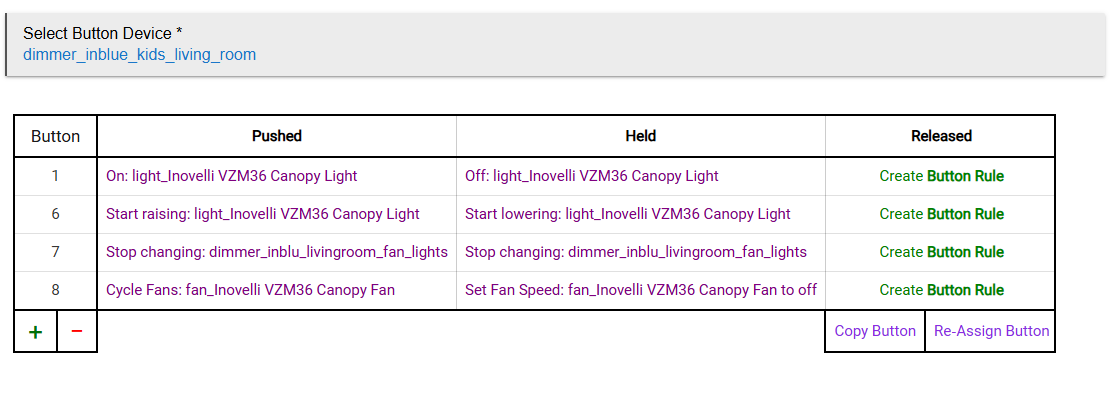

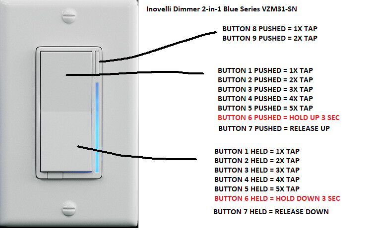

I was able to update the firmware to 3.04 on the dimmer. The fan driver are in beta (been there for 2 years). Not getting much response over at the Inovelli website so I just stopped with any bindings, seems they either dont work or I am not setting them up correctly. I ended up just doing button mapping. The blue mapping is a little different than the red version (dont know about the others).
