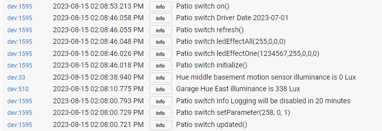

C8 hub, current software 2.3.5.152. Inovelli Blue VZM31-SN, driver 2023-07-01, switch pairs without difficulty. It is located about 5' line of sight from the hub. It will control the load from the switch but not from the device page. Setup information appears in the logs but attempts to turn the load on and off do not. Firmware update appears non-responsive. Current firmware info does not appear on the device page. I've tried two different switches. One from an early batch that was reported as good and one that was a replacement for one that was thought to be from a batch of defectives. I'm open to suggestions. Is there a setting I'm overlooking? Or could both of these be defective switches.

I misspoke, turns out for the Blue there are no older driver versions available. I was able to pair the Blue with a mothballed C7 and update the firmware. It seems to work correctly with the C7. When I brought it back to the C8 it behaved as before. Since this is one of the very early devices I'm guessing it is a hardware issue. Although I have no understanding of how it could work with the C-7 and not the C8 on the same Platform version. I did a soft reset on the C8 and a Pkg Mgr repair on the Inovelli Blue driver.

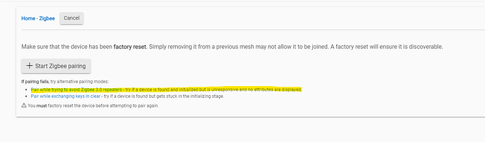

I am new to the C-8, but I did notice this info which seems new. Kind of sounds like what you experienced, but it doesn't make sense that the old driver would fix it.
The C8 and the switch are line of sight about 8' apart. There is a zigbee repeater very close as well. I didn't try disabling it. The switch would quickly pair but when I went to enter the switch name the switch led would quickly flash red twice. Looking at the logs there would be no further communications from the switch from that point. Is it possible that there is a hardware change since I received these switches. The one I just got to work was an early replacement for a first shipment device with possible issues.
