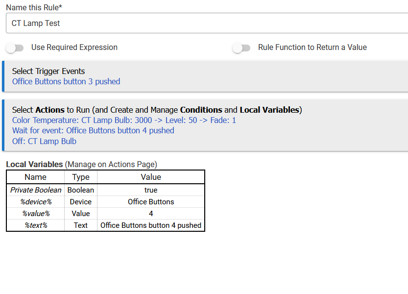

If I write a this rule in Rule Machine everything works fine.

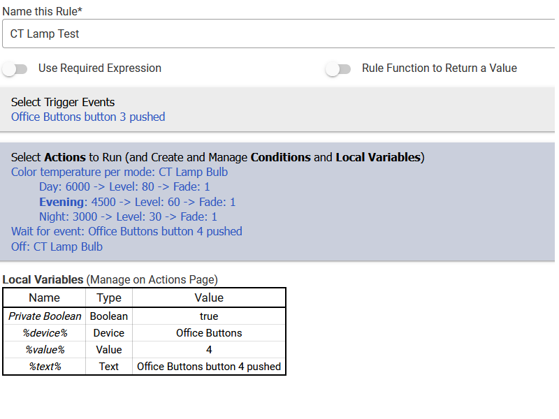

However, if I change it to this:
The app shows no errors in the log but the bulb gives an error
error:
java.lang.NumberFormatException: For input string: "0A00" on line 167 (method setColorTemperature)

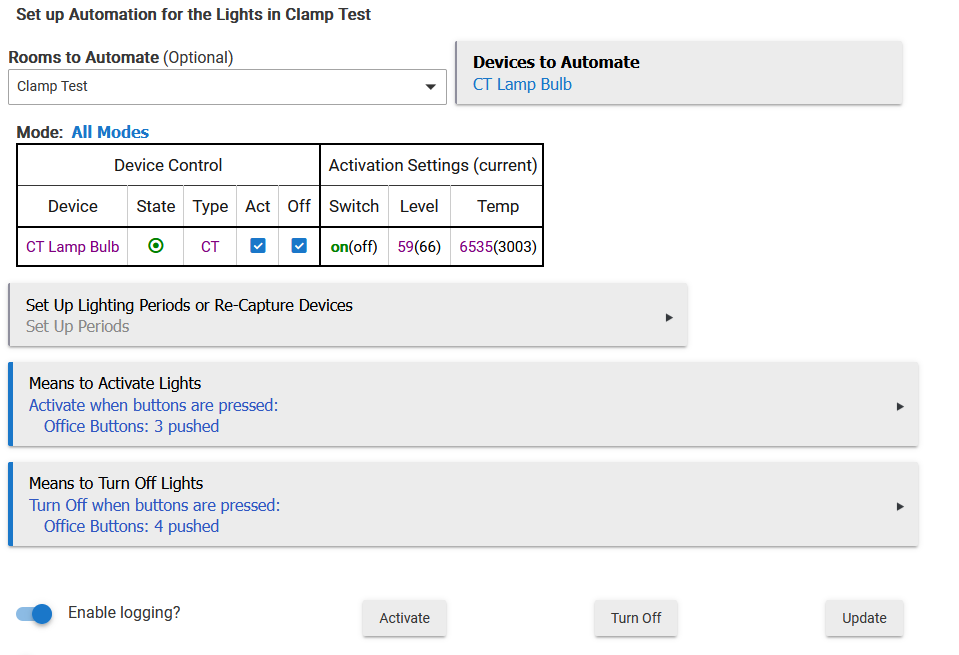

My preferred app is Roomlighting. I did this:
Doesn't work with the app saying:
info Already Activated
info Activation Event: 'Office Buttons' pushed 3
Any ideas? Many thanks for any suggestions.
