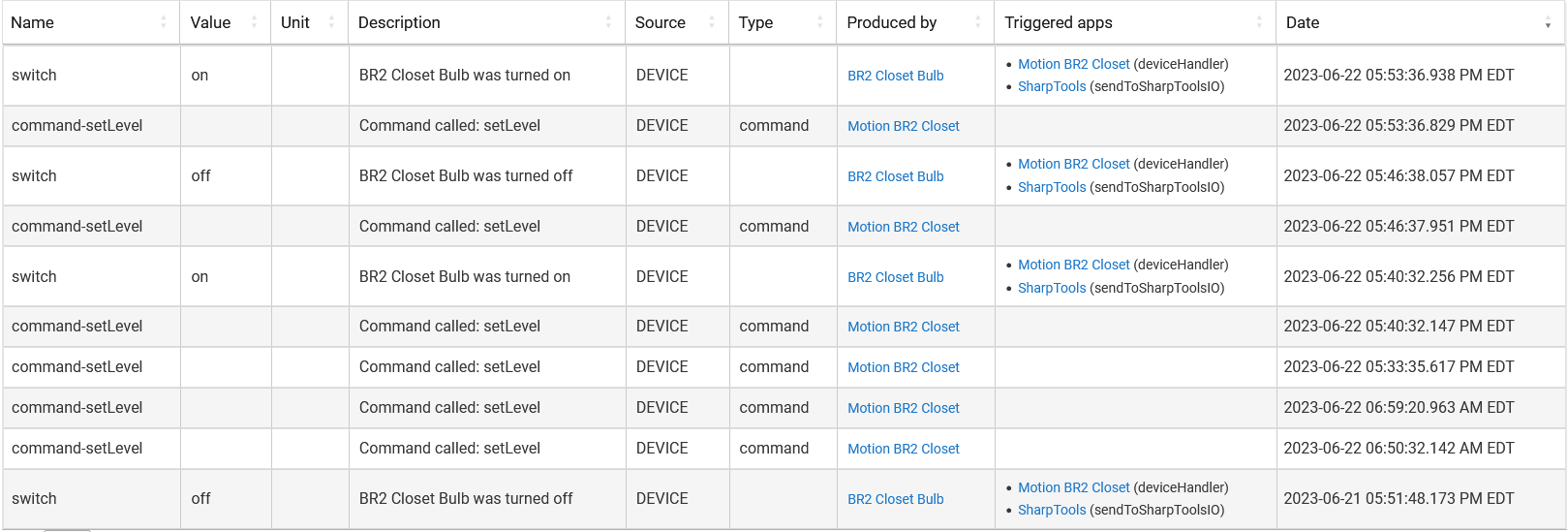

  • Events below show one bulb receiving the same command and behaving differently

Yes, the pistons are behaving as expected, as demonstrated by the commands on the device events page.

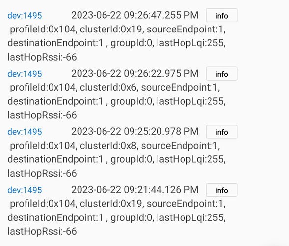

Fair point. I just pulled the following. To me, it looks reasonable, but I admit that I am also the person missing something.

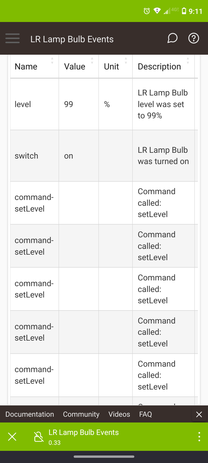

Ok. Not sure what, but something is going on here. I noticed that the living room lamp bulb was not behaving. While sitting on the couch, I re-saved the webCoRE app devices and it magically worked.
