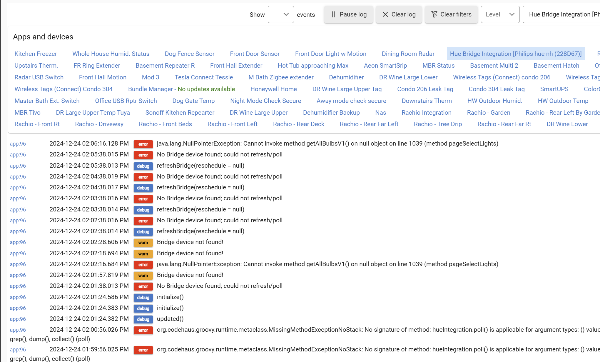

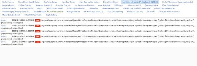

Innactive native hue bridge app (unused) starting acting up after upgrade to latest 2.4.0
cocoa hue bridge not working with latest update not in location..
so i cannot repair bridge..
guess i need to revert>?
trying a reboot with rebuild db first but not holding my breath..
@gopher.ny
nope still no bridge found.. reverting

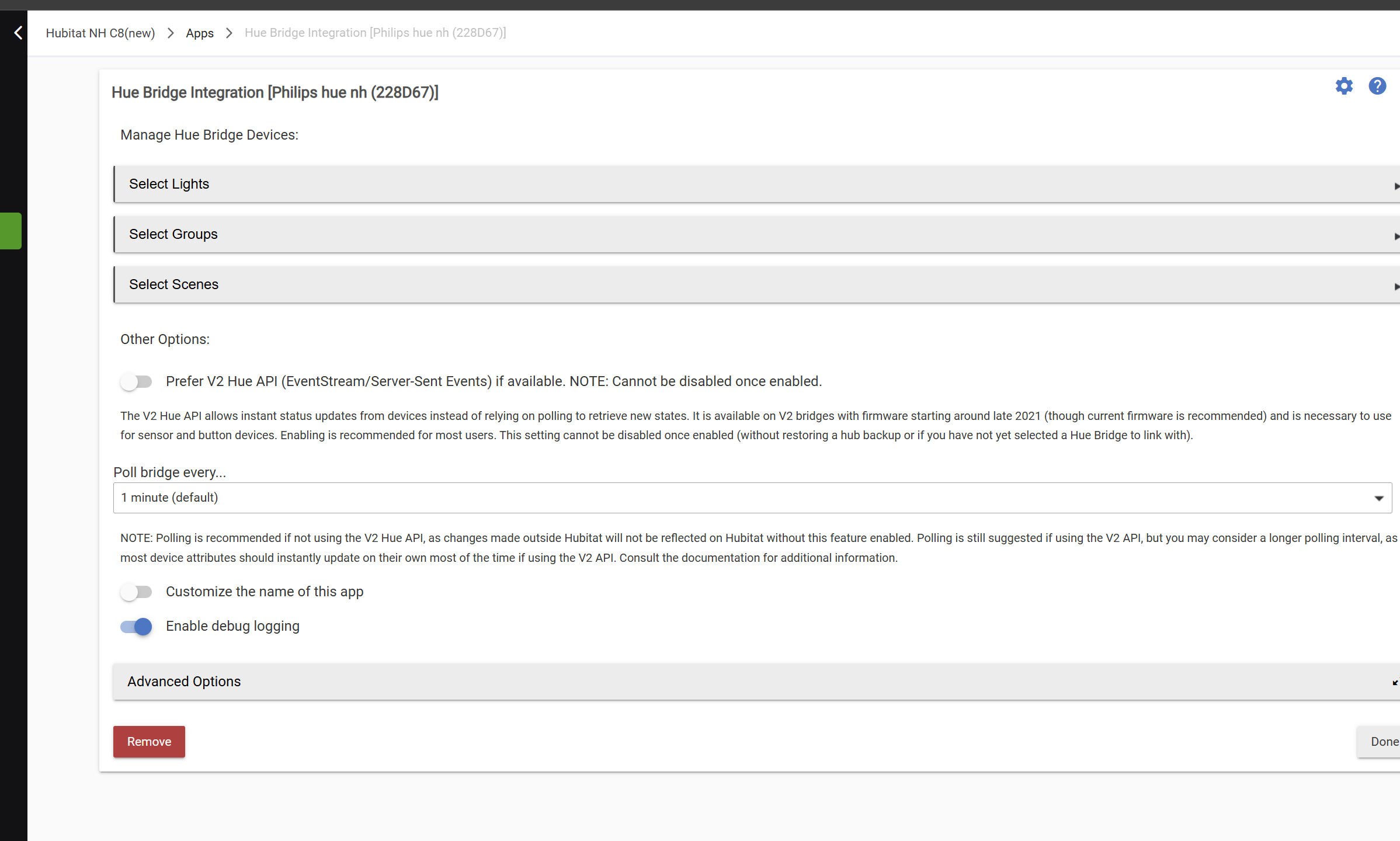

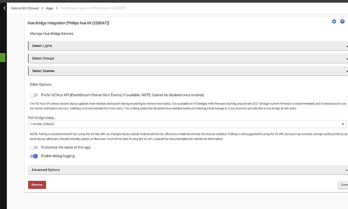

Go into the integration app and hit "Done" to see if that helps. Alternatively, run "Initialize" on the Bridge device. If that does not help, there are a couple more tricks I can offer. Looks like something went wrong with your upgrade.
If you do downgrade, I suggest restoring a matching database, per the release notes, if this is the built-in integration.
did that .. that is what caused the next bath of hub not found messages.
eveything else in the upgrade seemed fine.. no other error messages in the logs.. etc

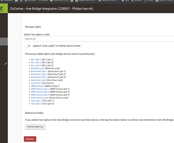

What app are you using? Your title says (or I think is supposed to...) CoCoHue, but your screenshots look like built-in.
Had both the native hue app and coco installed. Was using the native app for lights and the coco hue for motion sensors and buttons.
Had severe load problems when I enabled V2 API on the new hue version with the new build because coco hue was enabled at the same time.
@Bobby D said having both enabled would cause hub load issues. Ended up migrating everything to the new native hue app. Still having weird load issues. Trying to get to the bottom of them.
your right both apps are there only one being used. how can i tell which to remove and then fix this and try upgrading again.
stuff is working again after restoring backup .. db
devices all say coco hue so that is being used. old one is still loaded but not used.. will try removing it.
ok removed old hue integration that was not being used.. will redo normal and cloud backups then try upgrade again..
thanks.. think it just was the old hue integration with no devices (not being used) that seemed to kick in and cause issues after the upgrade
redoing upgrade now after leaving cocoa hue and removing innactive built in app.. think i will be good to go.. thanks for your help.
upgrade went fine and seems good.. cpu ws high for a while.. now down to 8% so all seems fine...
