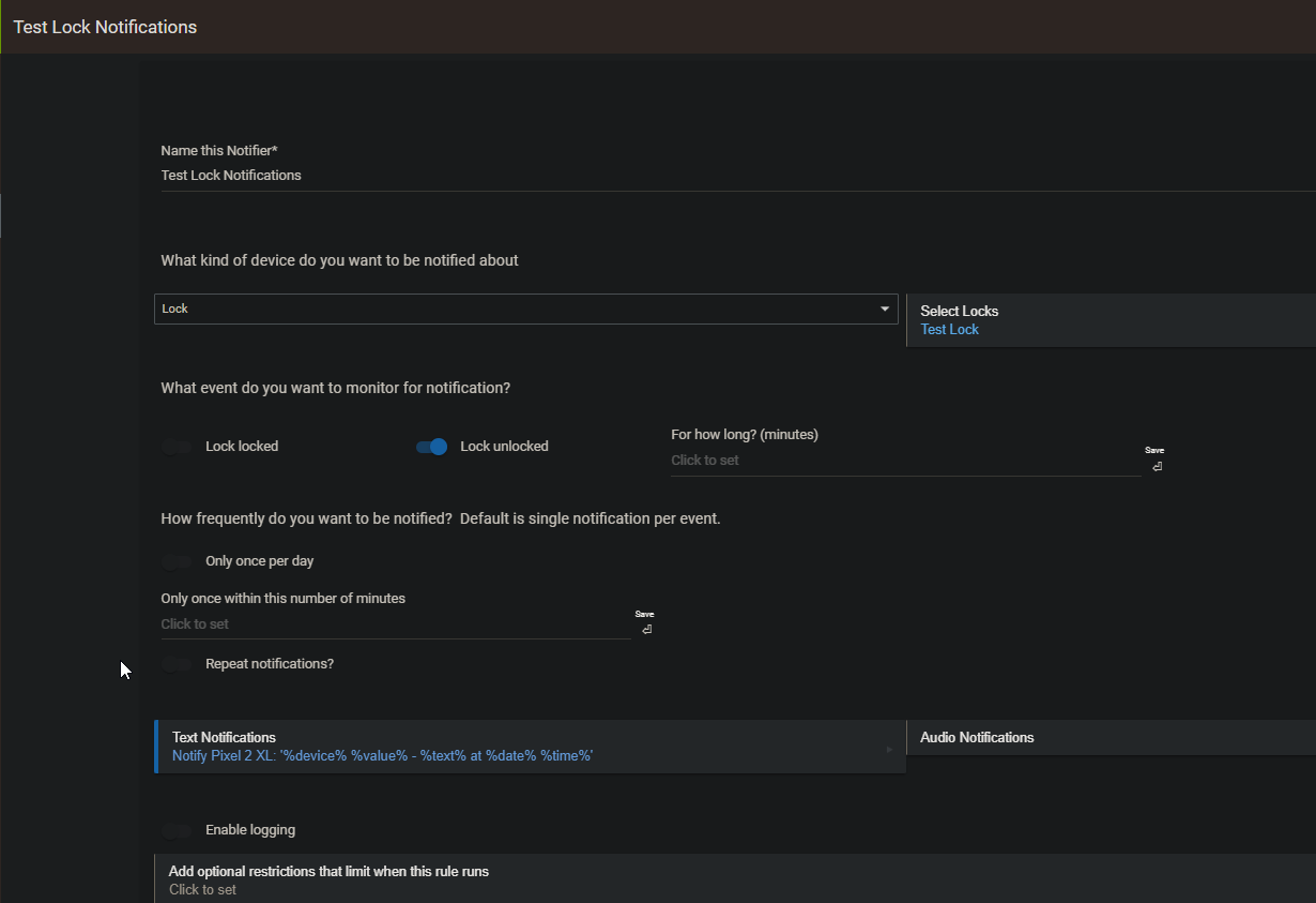

The built-in Notifications App will be what you want.
If you install this from the Apps page and setup a notification for your lock device, you could setup something like I have shown below. This produces a notification to my phone when the test lock is unlocked, letting me know who (the name of the lock code) unlocked the lock and when.
The message I configured is:
%device% %value% - %text% at %date% %time%
Producing a notification:
Test Lock unlocked - Test Lock was unlocked by Guest at 27-Jan-2024 03:26 PM
You can also add in other options for when to receive these notifications, writing them to a local file, plus others.

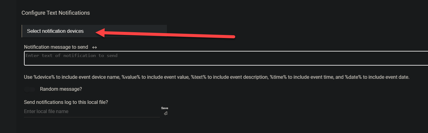

Thank you, Simon... this is exactly what I want... but it goes to the log... How do I get this to my iPhone as well??? :frowning:
When you are configuring the text notification, you need to select your phone here:
If you did that, then you are likely not connected to the hub in the mobile app, which would mean you would not receive notifications. Either that, or you have created more than one mobile device when connecting to the hub at different times in the mobile app and you may have selected the wrong one.

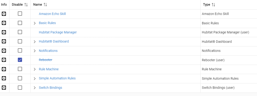

Wow .. Learn something new every day !
Never saw that app in the list .. wanted this for a few things!
