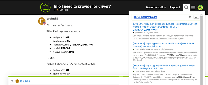

Ok, then the first one is:
Third Reality presence sensor
  • endpointId: 01
  • application: 4A
  • manufacturer: _TZE204_sxm7l9xa
  • model: TS0601
  • tuyaVersion: 1.0.10

Tuya TS0601 devices will typically require a custom/community driver. The easiest way to find the correct driver is to search this forum for references to the Tuya Zigbee manufacturer :
(copy and paste the manufacturer Id string into the Hubitat forum search field : )
(looking at the custom tuyaVersion device data I see that you have already found the right driver).

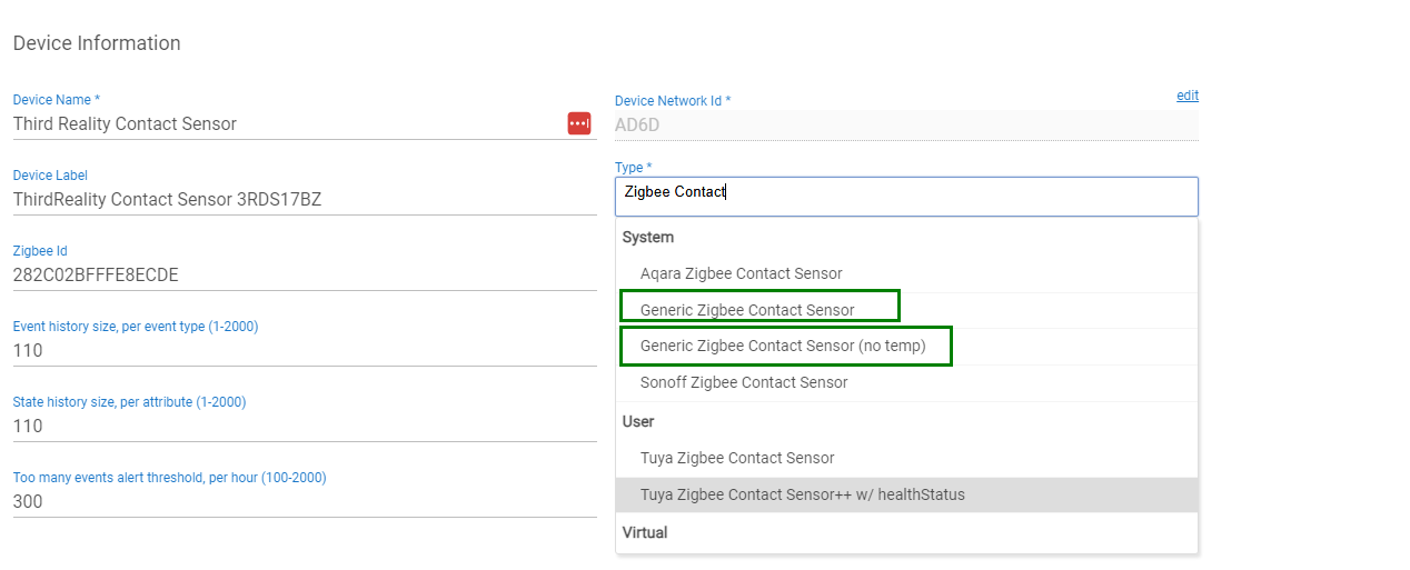

Most of the Tuya non-TS0601 model devices may work with HE inbuilt system drivers.
As this is a contact sensor - you can try drivers that have 'Zigbee Contact' in the name :

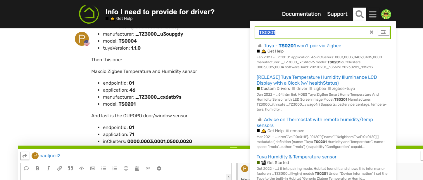

I will search first for ' _TZ3000_cx6atb9s'
The result is not encouraging - no one has posted for this device in this forum.

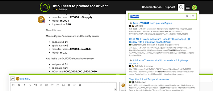

Then I will search for the more generic 'TS0201' model :
Now, the search results show enough information to find the correct custom driver ...
But before searching for a custom driver - try whether the HE inbuilt system drivers will not work? (most probably - yes, so you won't need to worry about custom drivers) :
IMPORTANT: For most battery-powered devices (especially Tuya's), it is not enough to just change the driver and click on the Configure button!
The majority of the new Zigbee battery-powered devices are 'sleeping' most of the time. They will not accept any configuration commands except in a short time period when they wake up (e.g., when a button is pressed, a contact is closed, the temperature or humidity changes). That's why after changing the driver you may need to pair the device once again to your HE hub (without deleting the device).

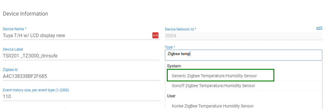

Next device - the Zigbee Temperature and Humidity sensor TS0201 _TZ3000_cx6atb9s should be a typical case where changing the driver to HE inbuilt 'Generic Zigbee Temperature/Hunidity' sensor may work straight away:
  • if not working - pair the device again
  • if not working with the stock drivers - search for a community driver that refers to _TZ3000_cx6atb9s
