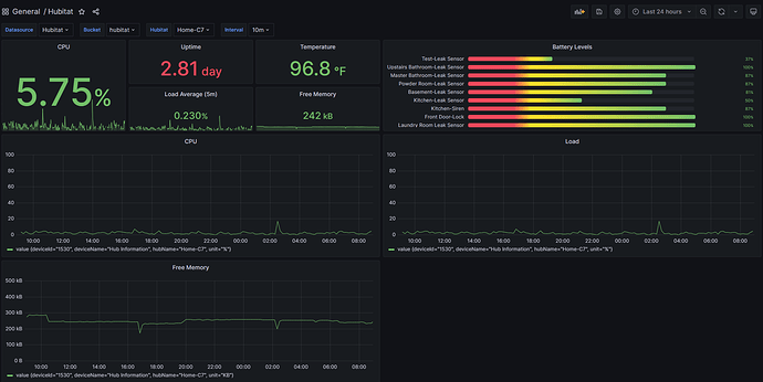

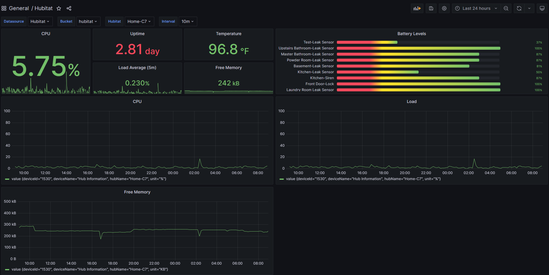

Dashboard is complete with most of what I wanted top track with my two hubs:

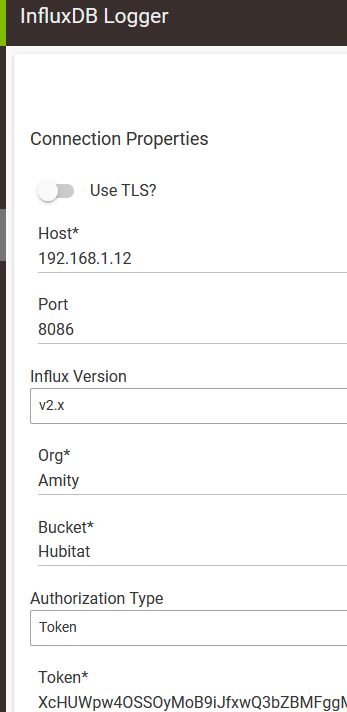

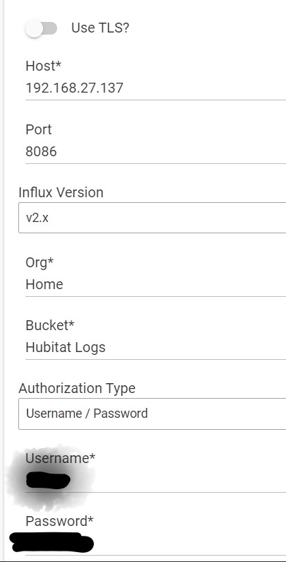

At a minimum, it appears you have a backslash that should not be there. Please post a screenshot of the Connection Properties page for the InfluxDB-Logger app.
You were right. I had bakcslashes instead for forwardslash. this is the ne error " Post of 50 events failed - elapsed time 0.103 seconds - Status: 408, Error: Illegal character in query at index 70: http://http://192.168.27.137:8086/api/v2/write?org=Home&bucket=Hubitat Logs, Headers: null, Data: null"

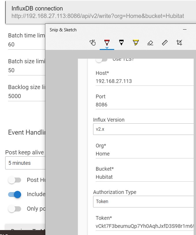

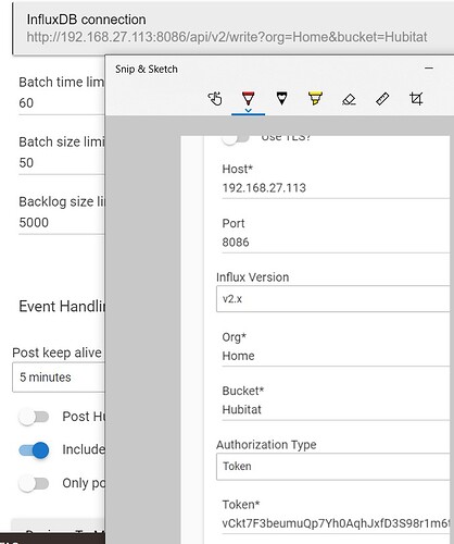

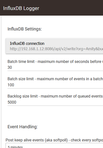

and aI am including a snapshot of my configuration
If you are running influxdb 2.x you will likely want to use a token instead of userid and password.
Though it is supported in 2.x, it is a deprecated way and requires a few steps to enable.
noted. I have changed it to token.
Could try using the org and bucket uuids instead of name strings (not sure about that space in the bucket name…)
Check the first page screen - is it formatted correctly? I see redundant http ' s in the front of the string. also - check for a blank at the beginning of string.
I removed the http, and I also figured out the ip address I was using wasn't the correct one.

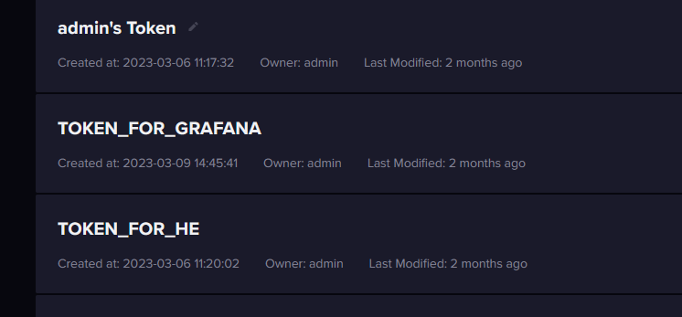

I want to also add - I learned over time to have 2 tokens - one for your grafana and one for your Hub so you can have kiosk windows etc without log in needed.

Did you create a bucket in influxdb and a token with read/write abilities to that bucket.
