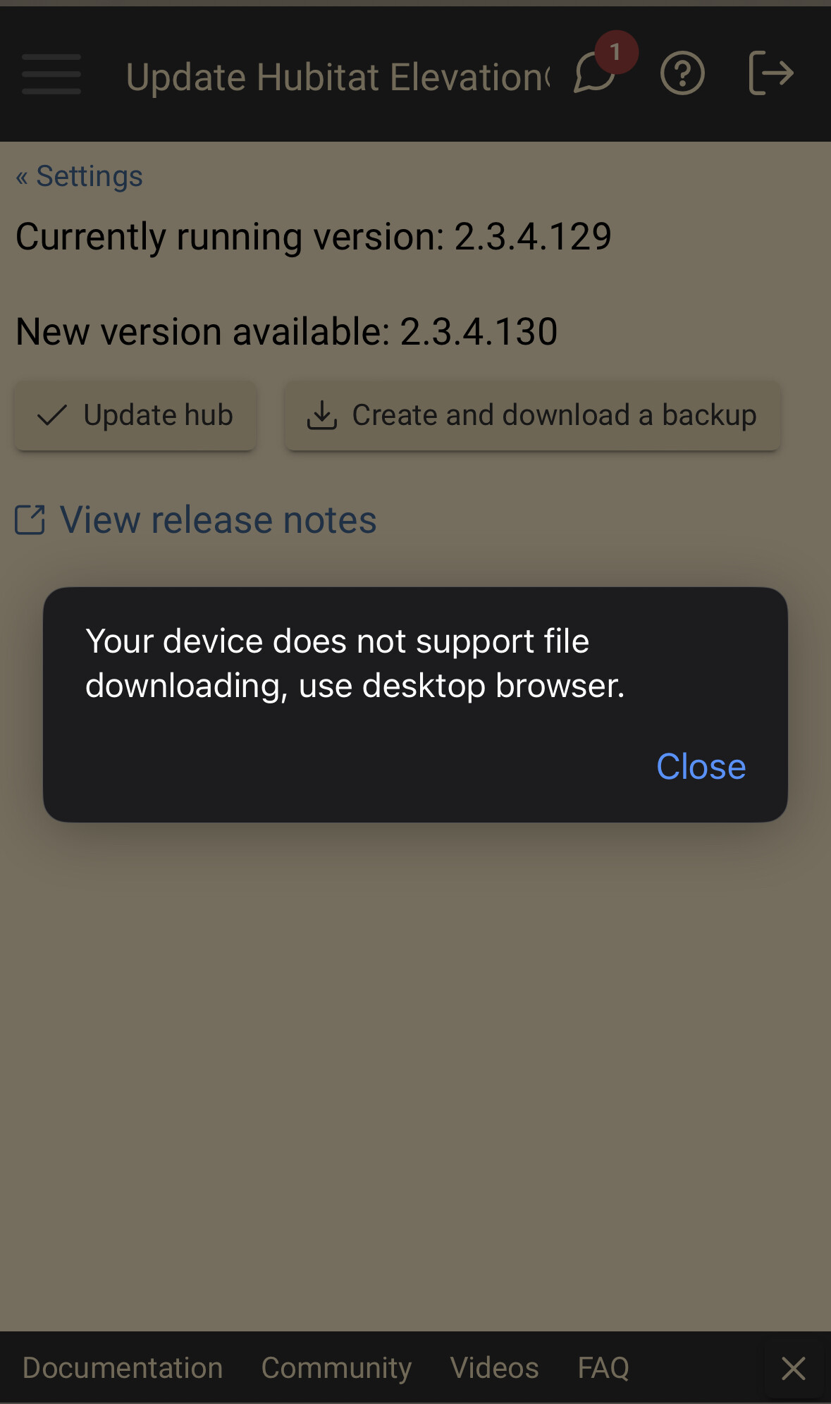

Incorrectly states can’t download backup on iOS
The option to download a backup when updating is not available on iOS. It incorrectly states that it is not supported.

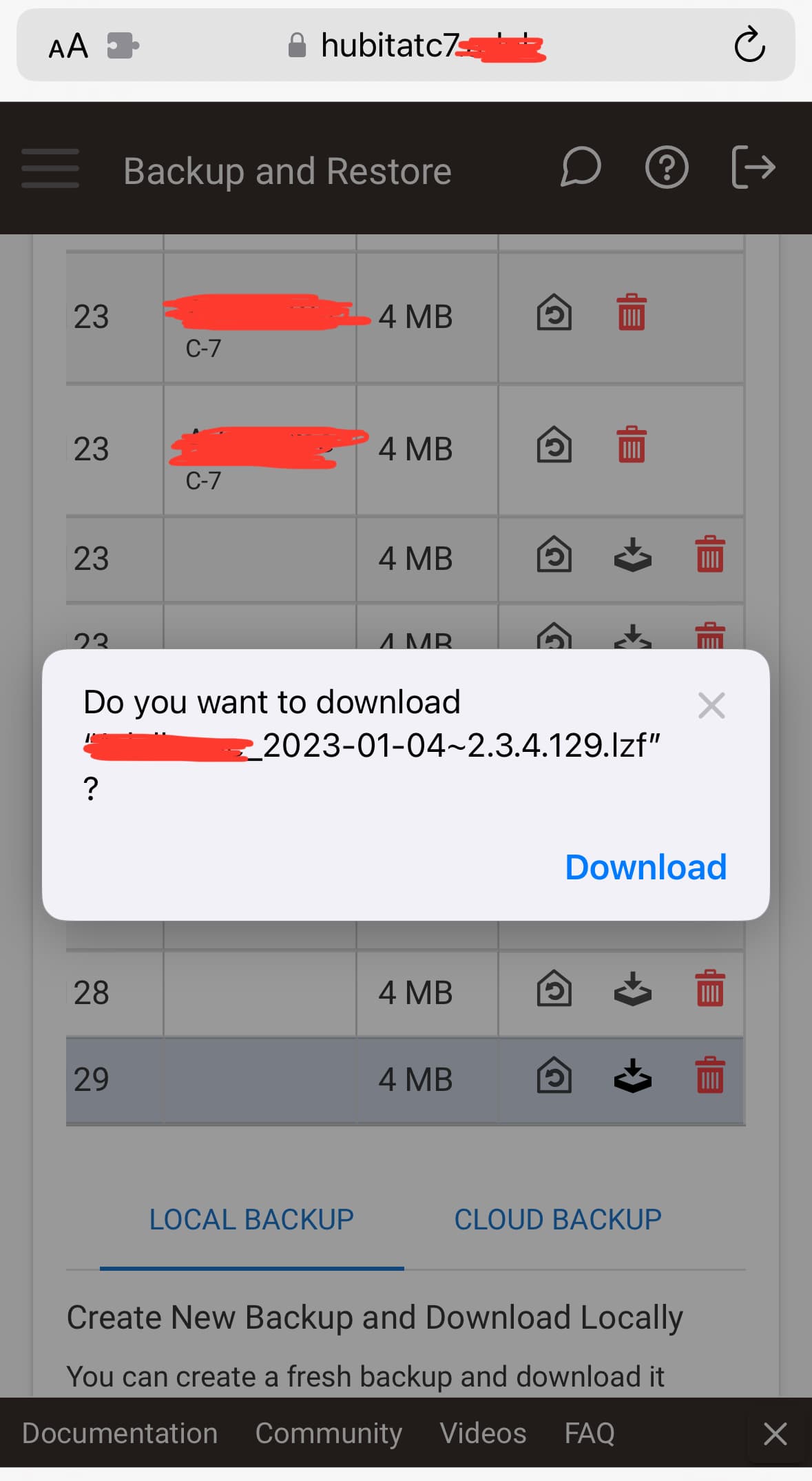

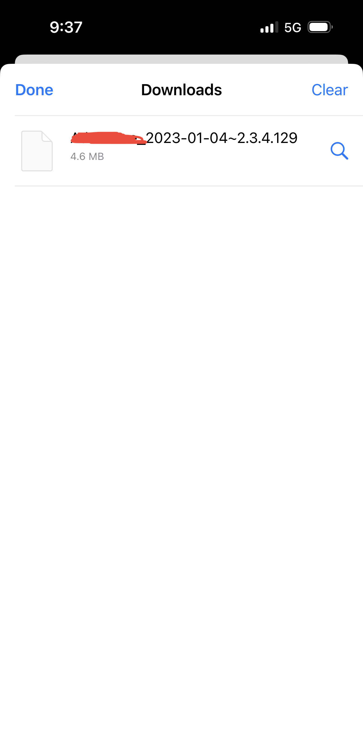

Fully Patched iOS (16.2) utilizing Safari. I realize where the bug is. It is on the update screen. I can download from the backup and restore settings screen, but the error occurs when you try to download the backup when performing an update. There is an option on that screen for download and it errors out there. (see original post first screenshot...which seems to have been a 100% accurate description and I didn't know it then! :slight_smile: )
