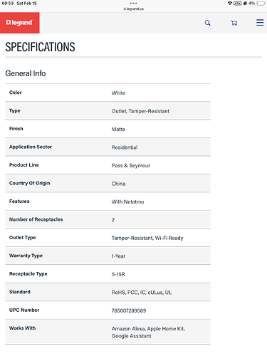

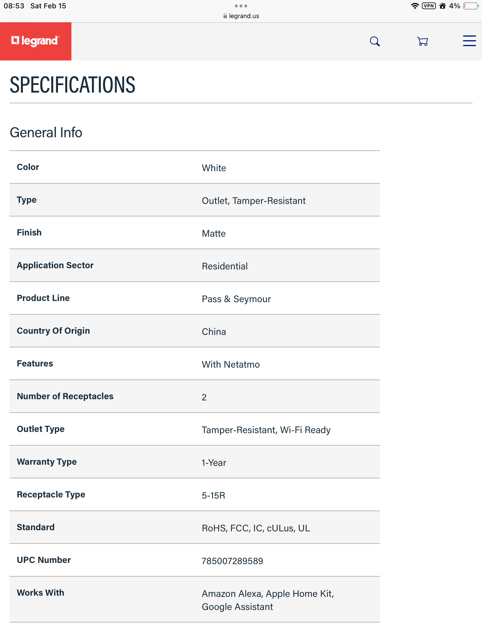

That’s not the device you linked to.
This is the device you linked to:
Look at the model number.
Neatatmo is zigbee.
The specs say it’s wifi. There’s nothing about zigbee in there.
I have had Netatmo devices. None of them were zigbee.
OK buddy. We are all crazy then running our zigbee outlets.
I don't know that that poster did to you, but I have 4 of them installed, and they are most certainly Zigbee.
I have trouble with the power reporting on mine, though, so it might not be the best option for the OP.
In fairness here, Legrand goes out of their way to not mention zigbee anywhere, so it's not obvious what they are using if you go by their documention alone.
I think they are trying to market this whole ecosystem up as some kind of walled garden to drive sales of their own stuff, but it does seem to just be basic zigbee under the cloak.
Not mentioning the word zigbee in the specs is confusing.
“WiFi-ready” is flat out incorrect though…
FWIW, Legrand also made WiFi ready, HomeKit-compatible devices. The specs on the linked device look like a HomeKit-compatible WiFi device. Although those devices had different branding.
Yep, no argument from me on that point -- but I suspect that's just more (intentional) smoke-&-mirrors to obscure what's under the hood. Mentioning "wifi" will cue to the average-joe consumer that the system is "smart" without scaring them off with talk of z-protocols.
But that approach only works if they keep said consumer in their own ecosystem. So that's kinda shady.
Or maybe I'm totally giving them too much credit here for being coniving - it's certainly possible they just messed up the marketing materials here :rofl:
Yet I linked you to a long discussion you could have scanned to learn about it. Slow down a little. This is an appropriate response.
No doubt. I just don't know why it required 5 different posts to argue an incorrect point.
FYI - I've read and participated in that discussion. The second post in there was from me, pointing out that it had the zigbee power reporting cluster.. I didn't realize that Legrand didn't advertise zigbee-compatibility in their own description of the device, which is what you linked to.
