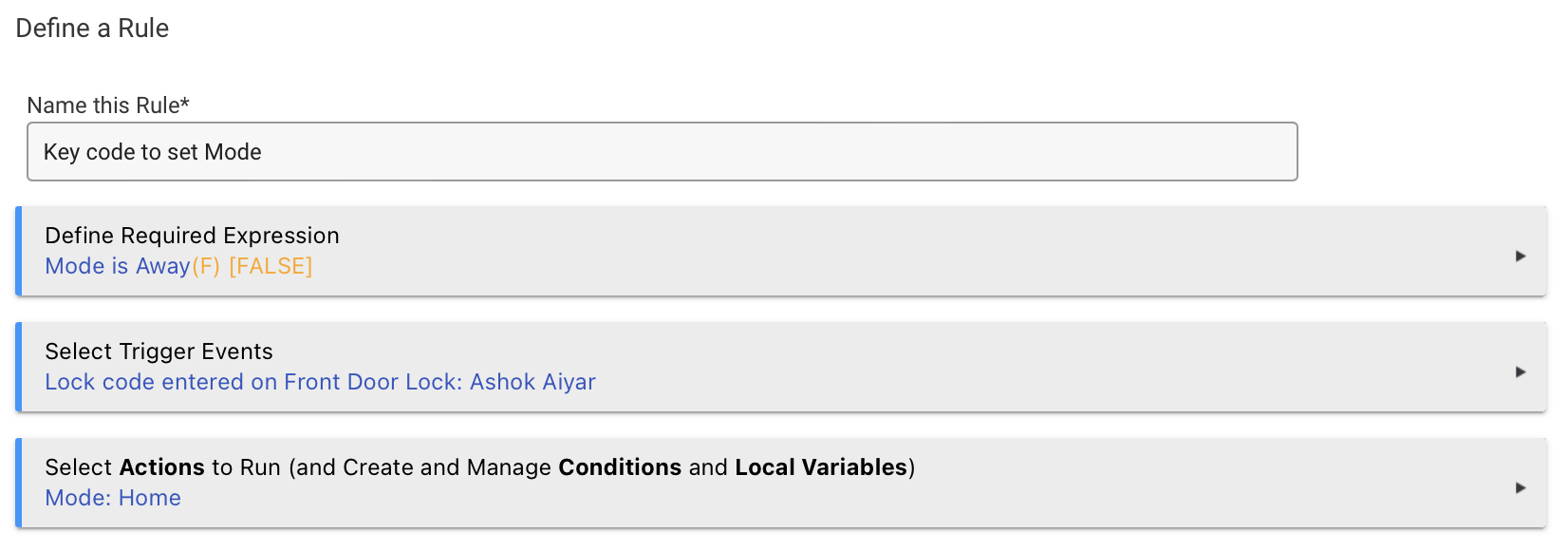

Just make a rule for it in RM.
How do I set a rule to "RETURN from away mode?" how does the rule know which mode to set?
Trigger: Key code
Required Expression: Mode is Away
Actions: Set Mode to Home
Something like this:

I'm not belittling you. The point is that Rule Machine can accommodate your needs.
In the example above, when you return from Away mode, you can set conditionals based on time of day to choose which mode to set between Day, Evening, Night etc.
