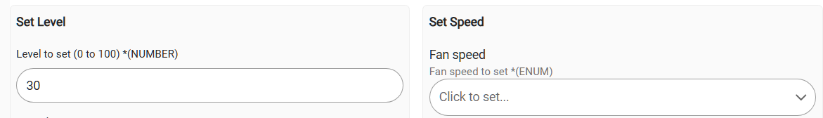

Asuming fan motor is AC (not a DC) use a driver designed by @bertabcd1234 and use a dimmer option for controlling fan speed instead of fixed predefined speed settings.
So to get this straight....
The VZM36 module with the FAN output and bertabcd1234 driver will give speed control from 0 to 100% and not just 3 or 4 speeds?
This is what I have been looking for and most/all the fan speed controls are 3 or 4 speed (mostly 3 speed).
Is the fan's light also dimmable?
Yes, driver supports both speed control modes - dimmer 0-100% and preset speeds:
I am using Dimmer forboth my fans. For my fans Dimmer function works very well even thought it is not officially supported. Also not all fans could be happy when controloled by Dimmer. I am glad, my two fans are very happy.

Thanks! I looked at the driver and noticed that for fan speed there are 11 possible speeds!!!
This is what I was looking for, and THEN some!
