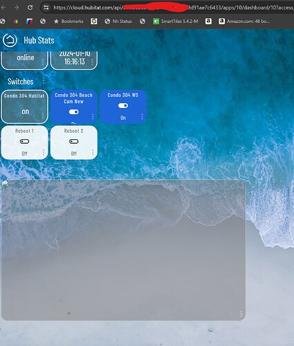

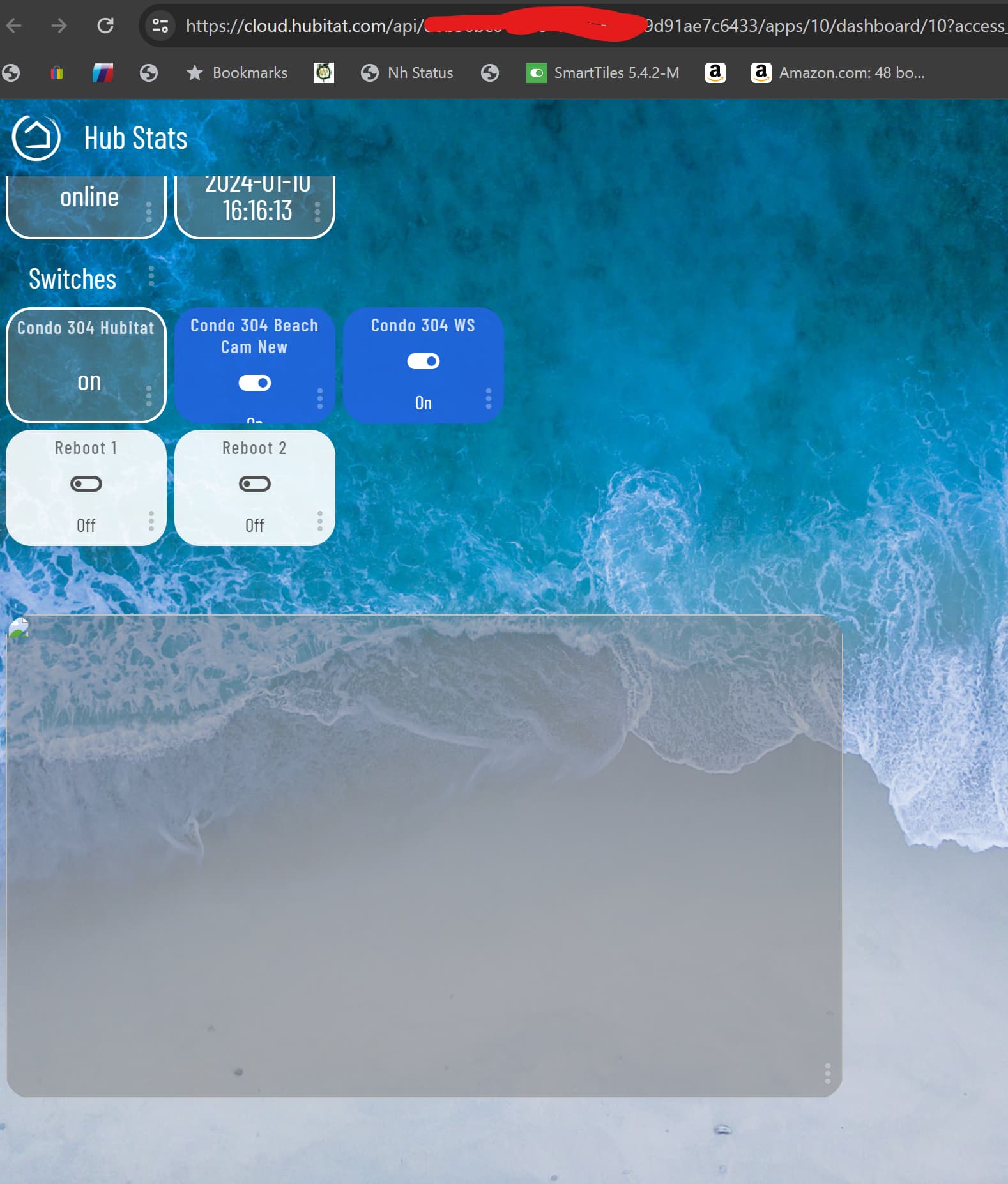

Image tiles are not working in cloud dashboard (possible firewall issue?)

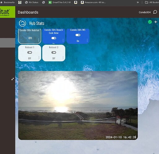

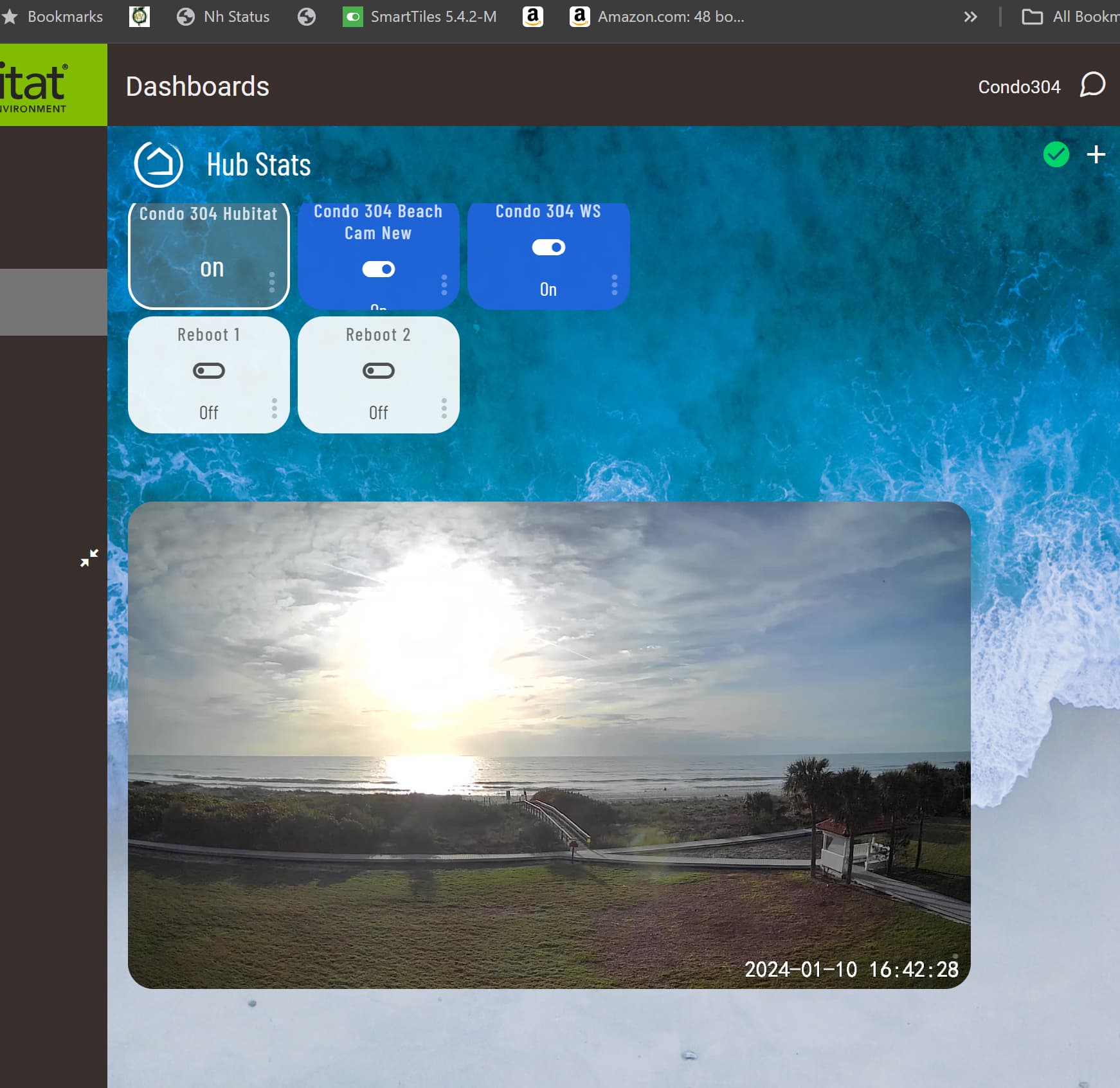

If i view the dashboard locally the tile comes up.. in the cloud version it does not work any ideas.

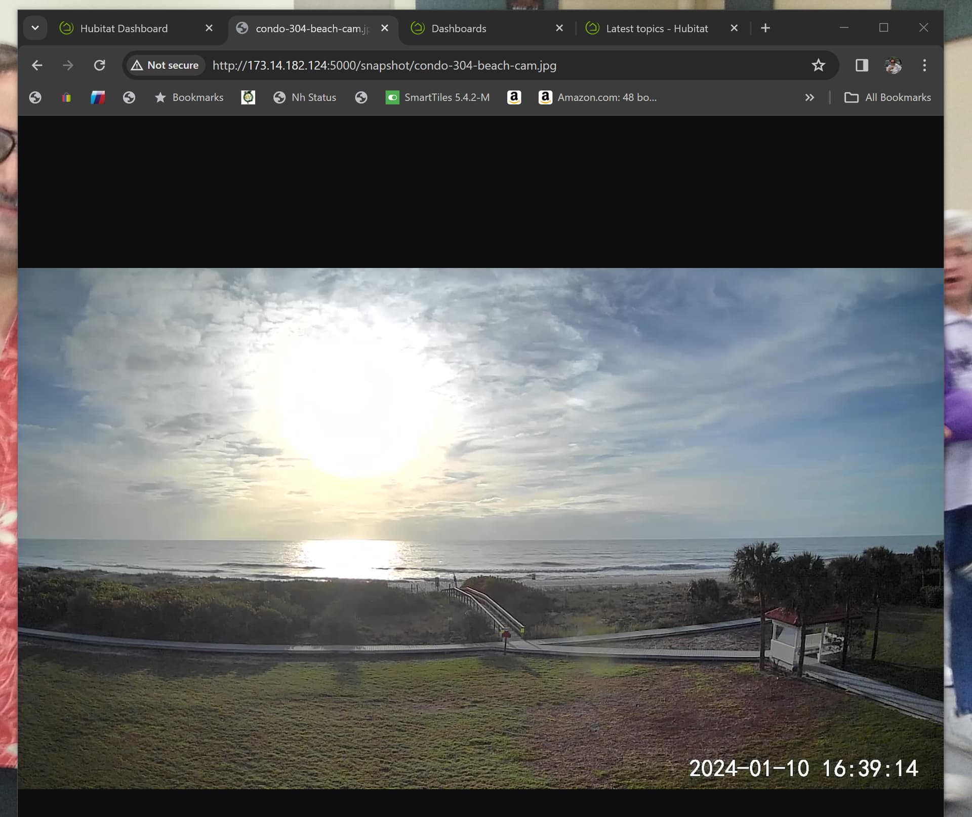

Port forward 173.14.182.124:5000 in your router firewall and forward it to the correct local IP:port?
If you can't see this image outside your local network with a browser then you won't be able to see it on the dashboard either. Port forward is not recommended. Maybe a VPN would be a better option.
Already did that obviously or the url directly would not .work..that is not the issue
I would have expected the image URL to be accessed by your browser, not the Hubitat servers, but I could be wrong.
Is that shot of the cam in a browser taken while you were not on your LAN?
Correct i am in fl. The lan is in nh
Your browser cannot mix https and http content.
thanks.. unfortunately it is hosted on my qnap nas (using wyze docker bridge) bridged to a different ip and i have not figured out how to get ssl on that ip...
