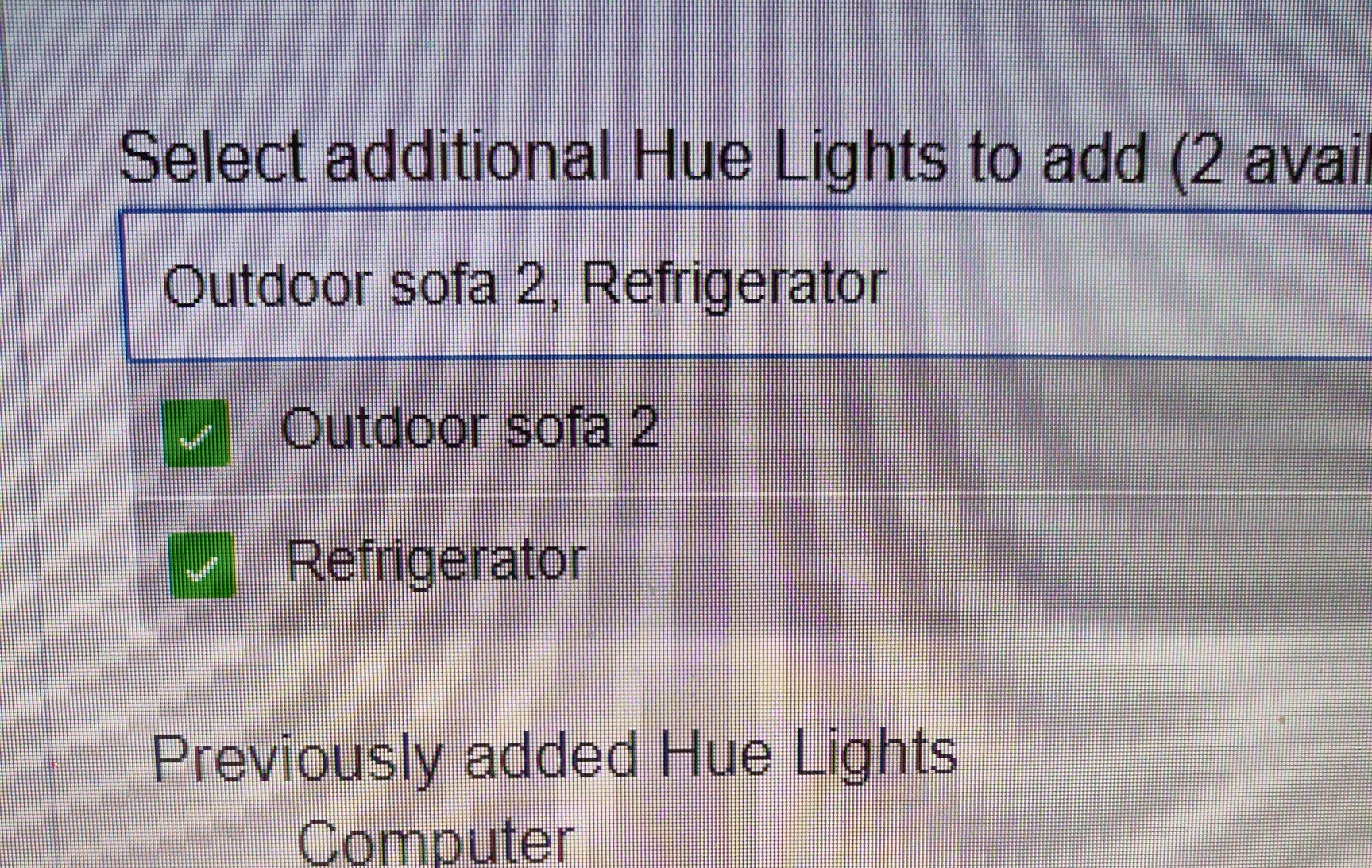

I added an IKEA outlet to HUE bridge yesterday but I cant add it to HE. It shows up under the Hue Bridge Integration and I can wing it off under Select additional Hue Lights to add (1 available) But no matter what I do it wont be added.

But I dont understand that I cant add it when it shows up as a hue light that can be added..
