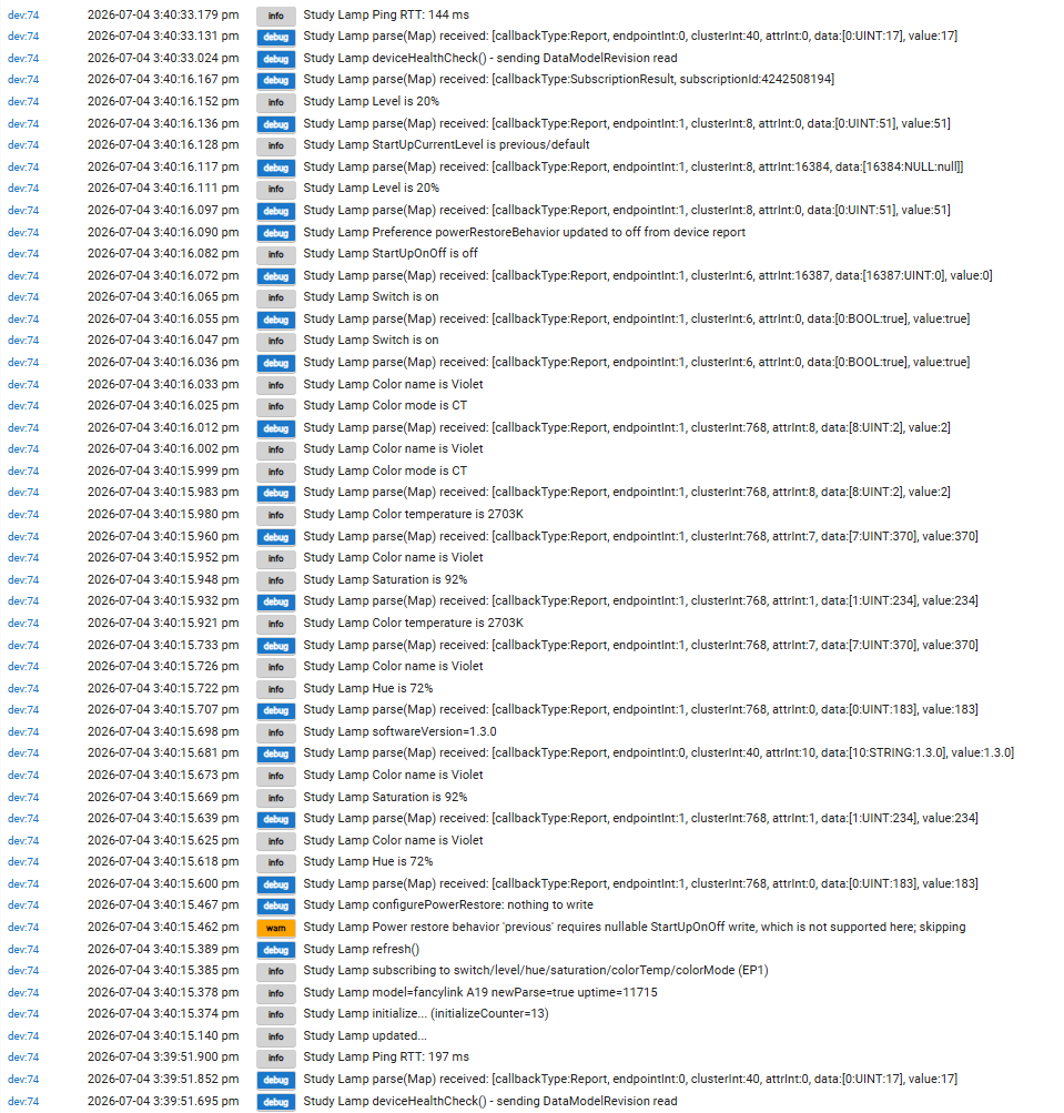

It doesn’t seem to restore previous state of off for me. I did make sure I was using the User driver that I had updated, not the System or generic RGBW drivers. And I did initialize. But after power outage, the light came on even though it was off when the power outage began.
Similarly, when set to power on to Off, it still comes on.

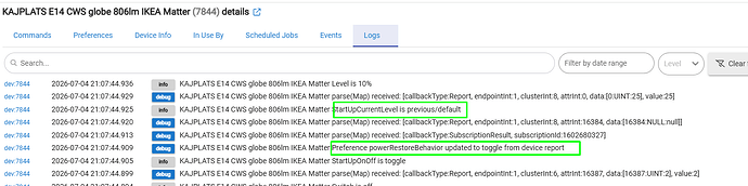

My model is KAJPLATS E14 CWS globe 806lm, maybe there are differences? :thinking:

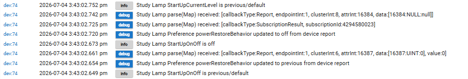

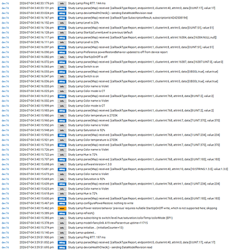

Observe the Debug logs when you change these new preferences, do you see confirmation coming from the bulb?
greatly appreciated !!!
will test it later 2night
Study Lamp Power restore behavior 'previous' requires nullable StartUpOnOff write, which is not supported here; skipping
but then switching to off ..
Can you try the 'toggle' option? Will it work for your bulb model?
Do you mean a Toggle command or toggle as an option for Power restore behavior? Either way, I don’t have it.
Scroll the drop-down menu to the bottom of the list.
The bulb should turn on and off alternately each time you cut and restore the power supply.

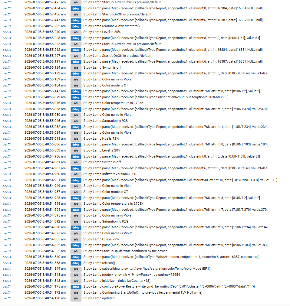

I’ve updated to 07/05 version and saved. Setting previous state preference then saving ..
Bulb was off and shows off in current state. After cutting power for 15 seconds and restoring, the bulb came on but it shows current state shows off until I Refresh ..
Thank you for the logs!. They look OK to me, what I see are the expected events.
Can you please try to summarize what is working and what not (for the new preferences only)?
From the perspective of the hub, everything appears to be working. I can set the preferences. If I have the preference set to restore state after a power outage, it appears to work as viewed from the device page. The bulb shows off before and after power fail.
However, the bulb comes on after the power fail even though it was off prior.

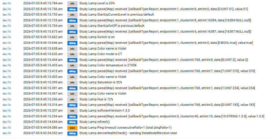

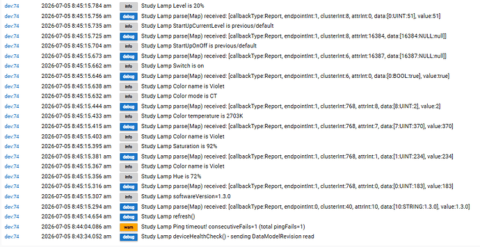

Maybe the confusion comes from the unknown behavior of the 'Previous state / device default'. What I understood so far, is that this option actually does not restore the previous state. It configures the bulb to activate the 'device default' state, which is programmed by IKEA to be ON? So, the label of the 'Power restore behavior' must be changed to 'device default' to avoid confusion.
Also, seems that the driver needs to send automatically a refresh() command after the bulb power supply was turned off and on, because the on/off state is not updated automatically in this case?
that is my observations as well :
- device default is ON at low brightness
- the state is not updated
