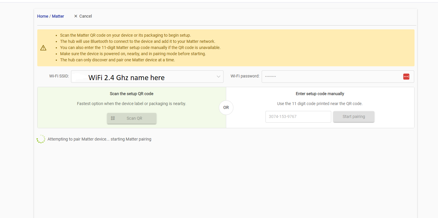

  5. Adding Matter device with code from Dirigera does not work, I get always this: Matter native cleanup is pending; retry commissioning after release
  6. Using Hubitat App (iOS) to add matter devices that are near ends on "connecting"...

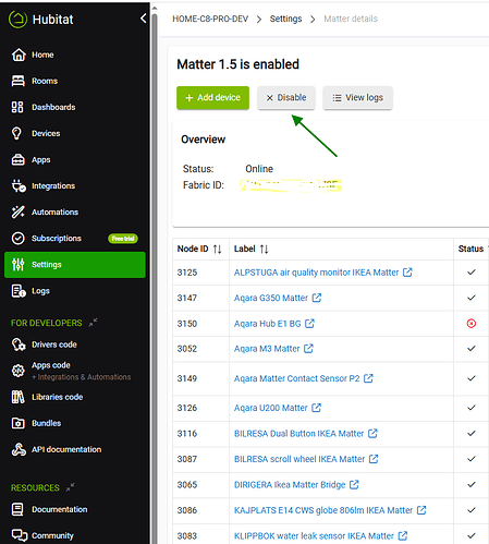

Another temporary workaround that you can try : go to Settings-> Matter Details
First disable, and then enable the Matter integration. This may help, till we are waiting for a fix.

Are you using a desktop browser when adding Matter devices to your HE hub, or you use the Hubitat mobile app?
Both have the same problem (mentioned above: "Matter native cleanup is pending; retry commissioning after release). Also I do not see in Dirigera Home Smart app code for adding Dirigera hub bridge to Hubitat anymore.
