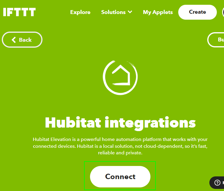

I've had a Hubitat connection set up in IFTTT for ages and today it stopped working.
After removing the Hubitat connection, trying to re-add it results in refusal to connect. Can someone @support_team please look into this.

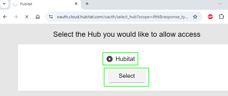

I was unable to replicate the issue. The connection works as expected. The problem is that your hub is not connected to the cloud at the moment, thus you cannot authorize any cloud based integrations.

@bobbyD How and why does a hub disconnect "from the cloud"?
My setup has never changed, Static IP connected via LAN, no WiFi, nothing fancy.
I'm paying for cloud backups so it would be nice to know when this happens because it's clearly unable to create those backups in this state.
Reboot the hub fixed the problem but that is not an adequate "fix".
