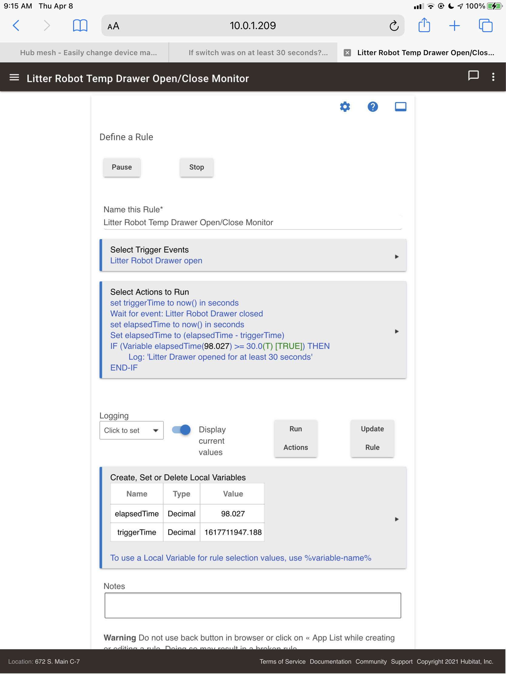

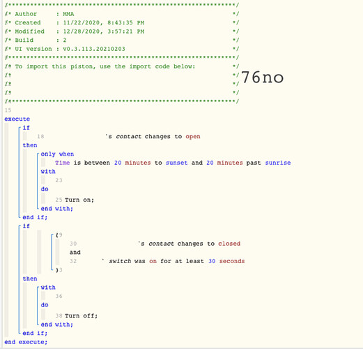

After being on Hubitat for over a year, Iām finally moving my automations over to Rule Machine from webcore. There is one automation Iām struggling to recreate.
How do recreate āswitch was on at least 30 secondsā as a conditional action?

Thanks. I didnāt get deep enough into RM to learn about variables. Guess Iāll do that next!
The reason it has to be done that way is that Variable Math (e.g., the subtraction, and the comparison) can only be done with variables, not time functions like ānow()ā.
