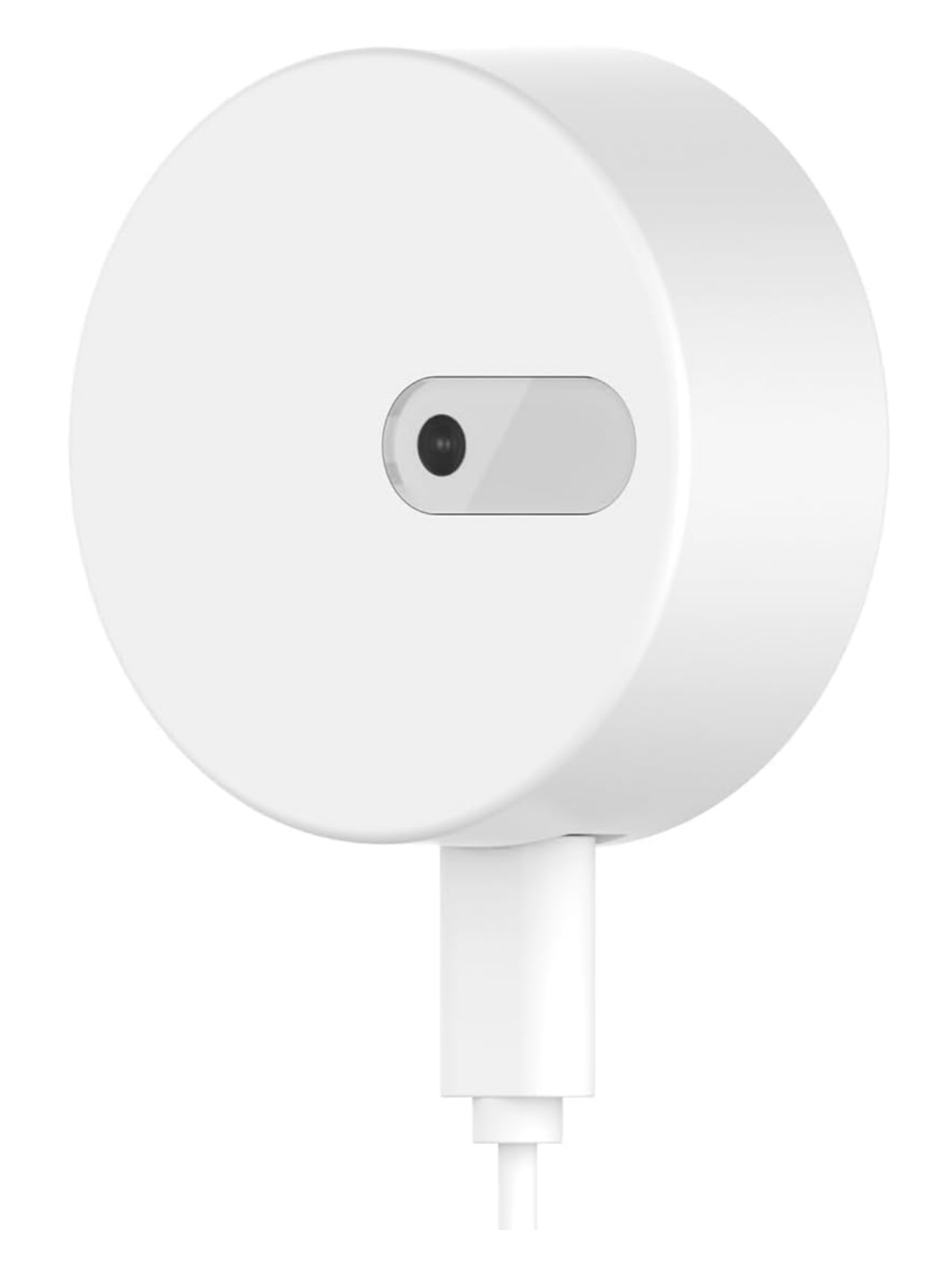

I don't know if these will help but they detect motionless humans very well - not PIR.
Human Presence Sensor ES1, Smart Motion Sensor with 24G mmWave Radar, Occupancy Sensor
They work with Hubitat directly. No Tuya hub required.
