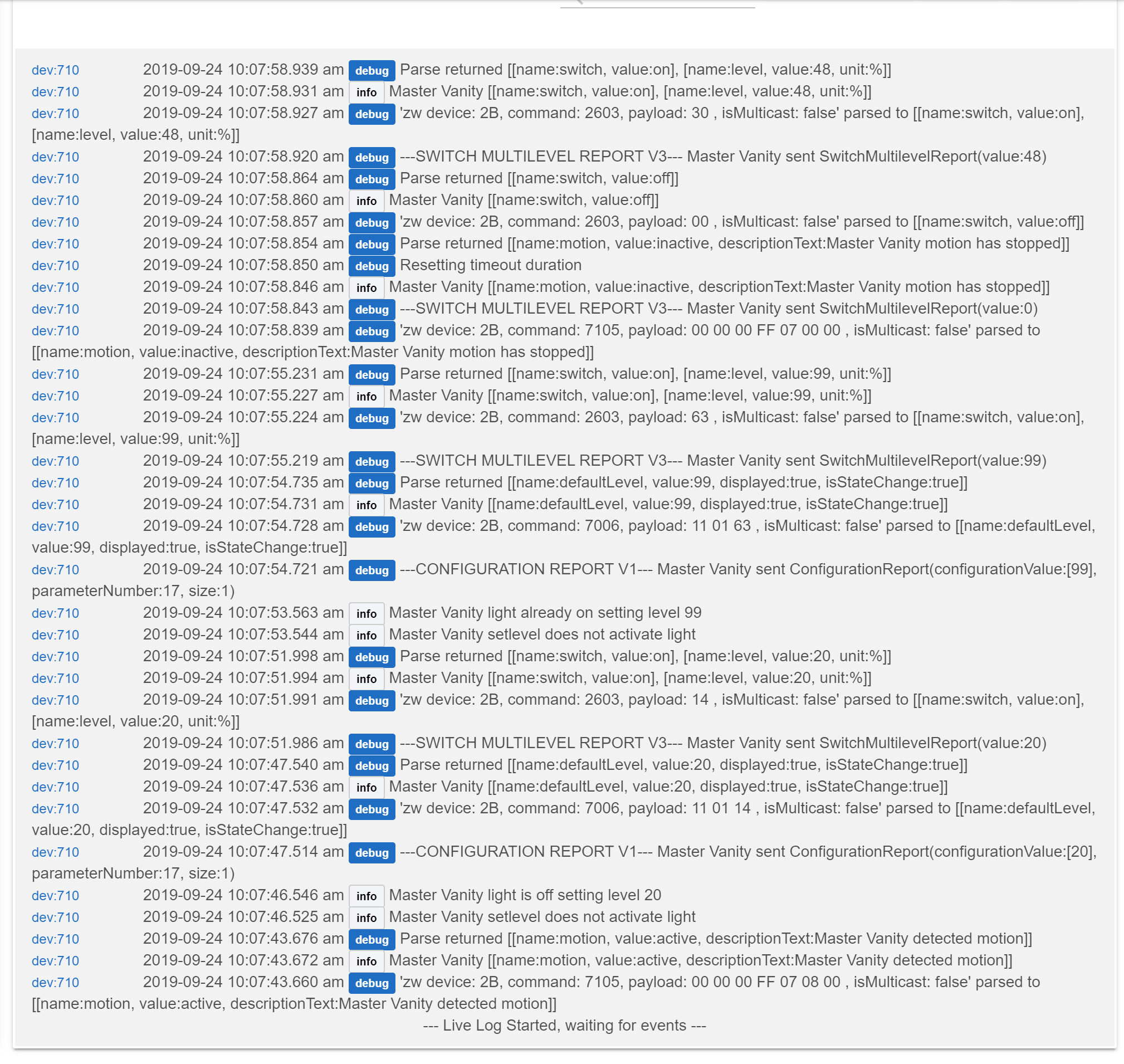

IF Condition evaluates False but still executes the commands
I will start by saying I a fairly new to Hubitat, but have been a long time Smartthings user. Many years ago a was a developer so while I don’t know Java really well I can read the code pretty well and understand what it is trying to do.
That said, Rule machine and its interface is new to me, but I am working through it, trying to convert all my WebCore pistons to the native Rule Machine and other Hubitat tools. I am having a problem with one of the Rule Machine routines I am trying to convert. Below I will provide the Webcore piston, my attempt at the Rule Machine Code, and the log from the device, and the rule.
I am observing a number of things. First, there is an if clause that is evaluating FALSE, as it should, but it is still running the commands contained in it as if it evaluated as TRUE. I have marked that one in the log.
Also, I may be misunderstanding how Rule machine works, but I thought that you did not necessarily have to have triggers set. My understanding has been that if you don’t use triggers, then it does a conditional match such that when the conditions become true, then the commands contained within the conditional statement execute. Is this true?
Also, I know I have identified a bug in the device driver I am using for the switch controlled here. The bug is that when a button is pressed the driver doesn’t seem to recognize it. I may be using the command in the rule wrong. I have marked the line in question. The only option in actions I could find to read a button press what the Button changed condition. I would have though that there would be an explicit Button 1 Pressed condition as there is in the trigger. Am I missing something? This has been hard for me to test because I don’t think the button press is even being registered by the driver since it won’t even register the event on Button Press 1 for the Trigger in this Rule. I have yet to be able to get in touch with the developer to see if he can fix it, and I doubt you will assist since you have built your own driver for the GE/Jasco Motion Dimmer. Unfortunately, your driver is not nearly as functional, nor does it have as many custom commands, commands that I have made use of on Smartthings, and would like to on Hubitat.
So here are the screen prints. Any help would be appreciated.
Any assistance is welcome,
Thanks,
LJ

No; that is a webCoREian way of thinking, and it is true there (except I can't remember the terminology; something like if you don't use triggers, it will infer them based on "plain" conditions, though all are ifs and many new users have a hard time knowing). In Rule Machine--or more accurately Rule 4.0--your actions will run only when an event matches one of your triggers. It is true that you don't need triggers, but you need to run the rule actions via some other mechanism then (e.g., calling it from another rule) in order for them to ever do anything.
A button press is an event and is best used as a trigger. It is difficult to use button pushes as conditions. You technically can do so (generally as checking the last button number as a condition), but it's unlikely that you want to do so, and I'm really not sure how you got "pushed() *changed*" into a conditional or what that even means (certainly not what the webCoRE piston does in the corresponding section). If your driver is custom, there may indeed be a bug, but if you see button presses (and other events) in the logs as expected, then it's likely working fine.
My suggestion would be to leave this out of the rule--make another rule (or some other automation) to handle the button push. A separate rule with a "Button Device" trigger would work well (that's basically Button Controller, plus a bit more power from Rule Machine). I see you're setting a local variable based on this, which you can't do from another rule; rather than using a global variable (also an option), you may wish to consider using the rule's own "Private Boolean" to track this state, which you can set from another rule. I think keeping the button in here is going to get messy, though--it will evaluate all your conditions and run other sets of actions of the conditionals match.
Beyond that, most of the rule looks OK to me, but I still think you'll get some unexpected events with your multiple vastly differing triggers. What if the vanity gets turned off but motion is still active? Your rule actions will match on the first conditional and turn them back on. Separate rules with their own trigger will likely make this much less complicated. Also, do you plan to have the lights turn off with motion, too? (That would be something you could probably put into this rule.)
