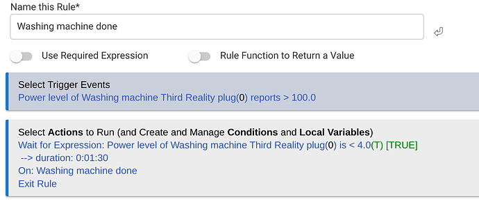

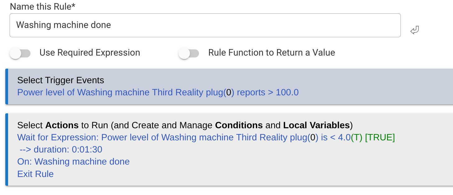

Third Reality plug with power monitoring works well for me. Inexpensive and readily available from Amazon. My rule works for my machine. It may require an adjustment for your washer. Third Reality plug with power monitoring
Device "Washing machine done" is a virtual switch using the user Virtual Switch uDTH Lite device driver, author sab0276 (set preference as a contact sensor). That is shared to Amazon and triggers an Alexa announcement, "Washing machine done."

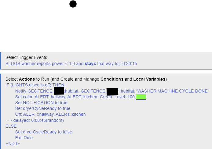

I extended the duration on mine because I use the "pre soak" feature.
