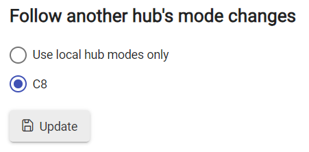

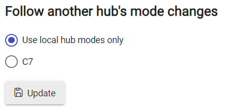

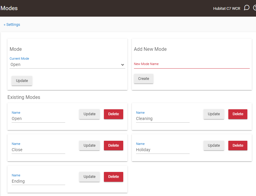

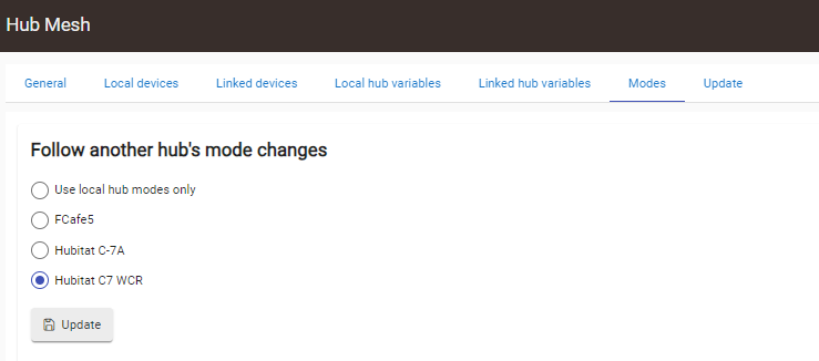

This is the C7 setting that is following the modes of my C8.
Here is the C8's settings.
I'm assuming you are doing the same.

I posted the setup I use for one hub to follow another hubs modes.
Not any rules/pistons etc. to change modes.

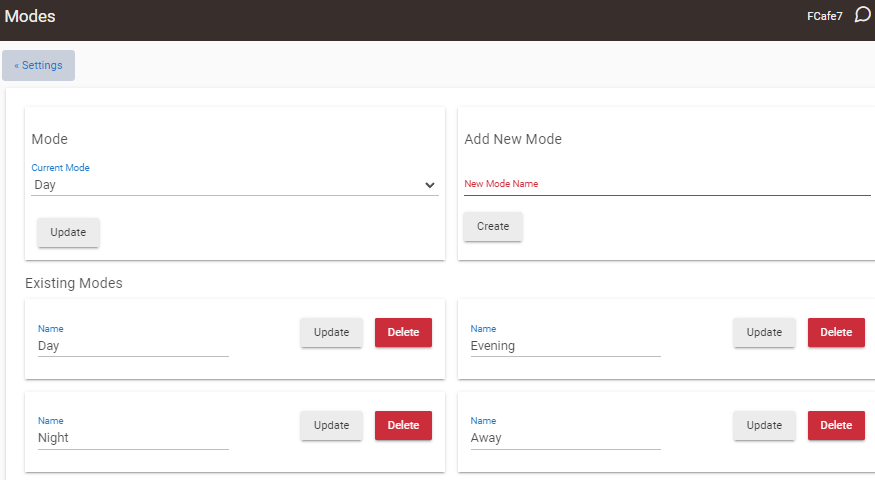

Reading between the lines of your post, have you defined the modes 'Open, Cleaning, Close etc on all your hubs.
You need to do this to have one hub control them. The modes do not automatically copy across to the other nodes from the 'Master/Control' hub.
Interesting... I did not know that..
Nor did I and personally I think it should.
I just did some testing and that seems to be the case.
As I only use the 'standard' pre-defined modes, it's not something that has reared it's head for me.

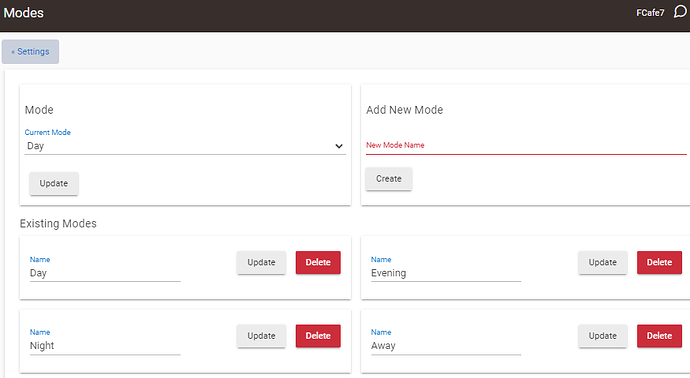

I made the Mode of other hubs the same as your advice.
Then the mods move together. Thank you.

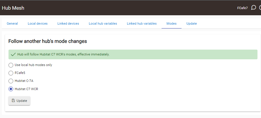

No special options are required.
Make the Mode element of each hub the same,
As shown in the picture above, it's enough to set it to use a different hub's mode.

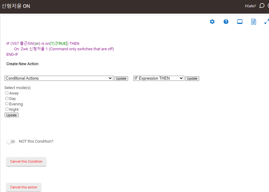

I've added Mode to one hub now, and I've tested it.
Only modes of the same element are synchronized,
Naturally, other elements cannot be synchronized, so it seems that they can be used alone.
The conclusion is that only the elements of the mode you want to use together are the same, and the elements you want to separate can be used differently.
