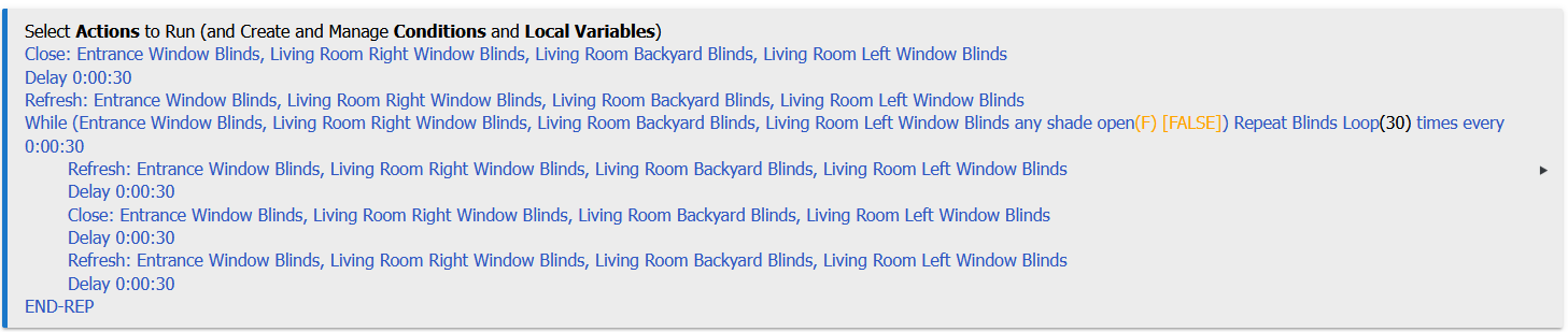

I'm doing a repeat while loop, essentially looking at the status of the blinds and if anyone of them is open/closed then it will pass through the actions again. Here's a snip, I have a global variable setup determining how many times I want it to repeat itself.
So the first step is to send the command, then delay, then refresh, then loop. This is all in an attempt to wake them up.

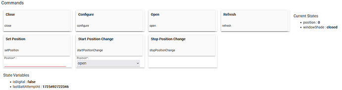

Today they all closed properly except one. Looking at that one, it currently thinks it is closed but it is in fact open.

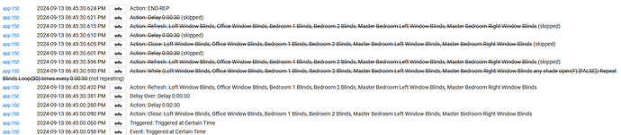

Here are the logs for today:
That would be why the loop isn't running. But again, I don't think refresh does anything for this. For some reason the blind reports or believes it is closed when it is not. The only way I have found to fix this is to manually send open command and then close. I have one that I stopped fighting and now set the position to 1 before send close command to the rest of the group. I guess I should contact them about it and see what they say but really haven't had the time or want to do massive troubleshooting. Position 1 is so close to closed that it is good enough for that blind. But if you have more than 1 doing this than it would probably be a bit more annoying :slight_smile:
