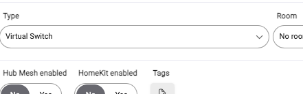

You can substitute a virtual switch for the real one, turn it off, and then switch back.
Screenshot 2025-01-19 at 11.33.50 AM
Memorize the driver you are using, swap to use the Virtual Switch driver, save, then turn it off. Swap back to the memorized driver and you good for another year.
