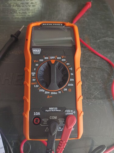

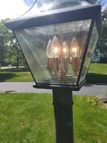

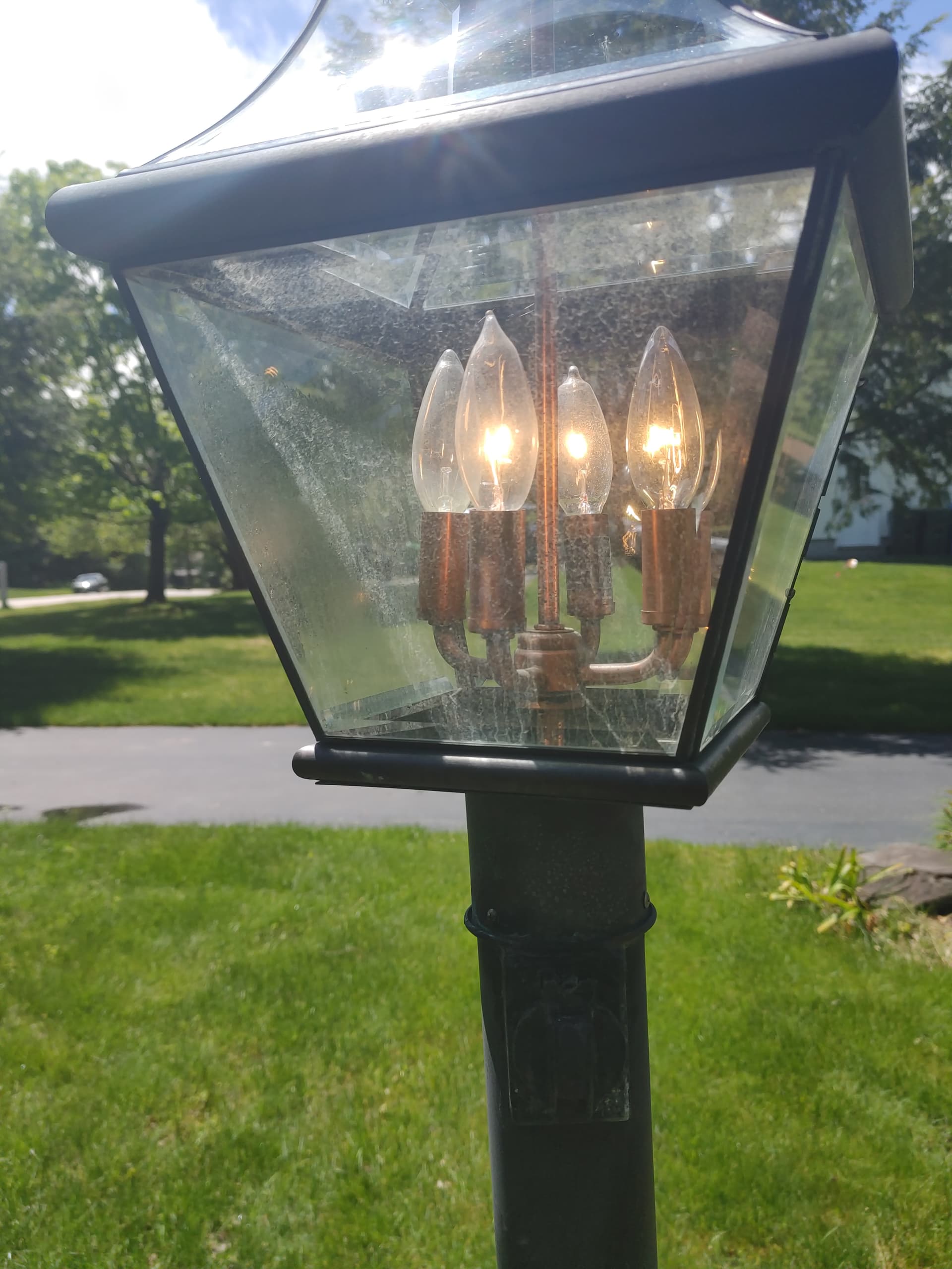

yeah got it working . the right tools for the job help
Tell us what the problem was. This like reading a bedtime story to a kid and not finishing it :wink:

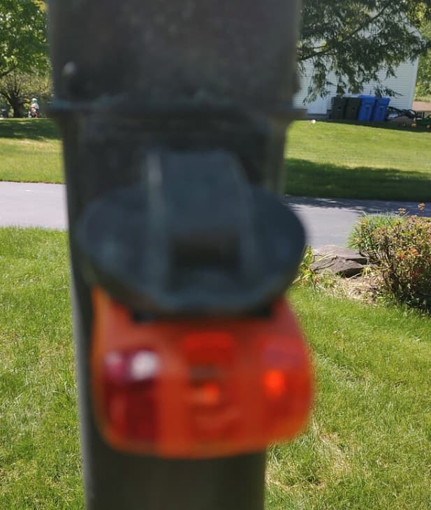

the pole lamp did connect to switch.. worked once i disconnect and then found the break and fixed it (shrink wrap etc wire break kit) then reconnected.

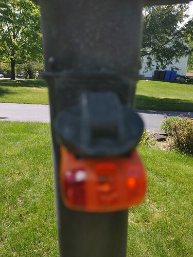

Nice of your camera to focus on the bins across the street. :roll_eyes:

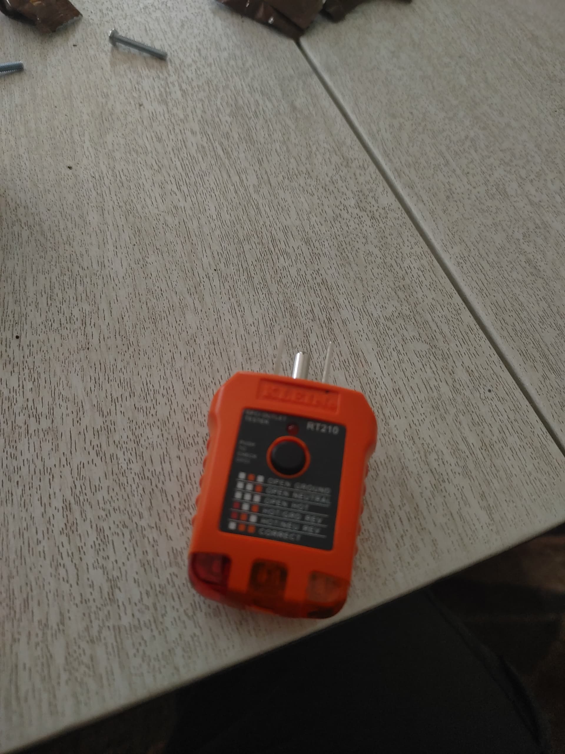

Some sort of reciever? :thinking:
How did you find the break? Inquiring minds want to know...
I was focusing on the lights couldn't get closer and farther couldn't seem the lights. it senses the circuit and tells u any problems

see above link for device to find broken wire.
The voice in my head at times like that.
Focus you *uck!
