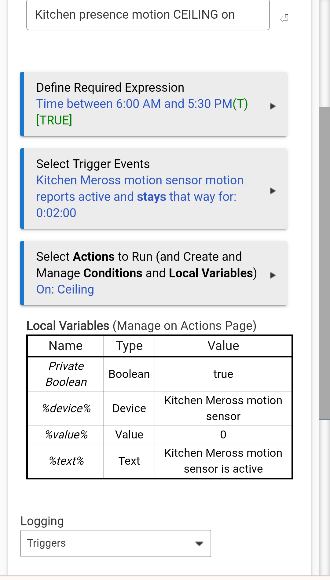

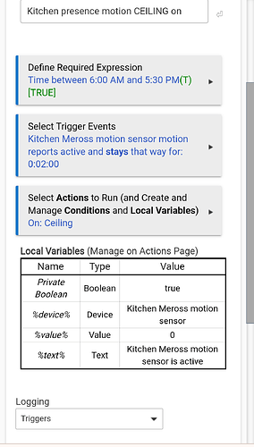

Would this meet your needs? In Rule Machine:
Trigger: Motion Active: Duration 2 minutes
Action: Light:on

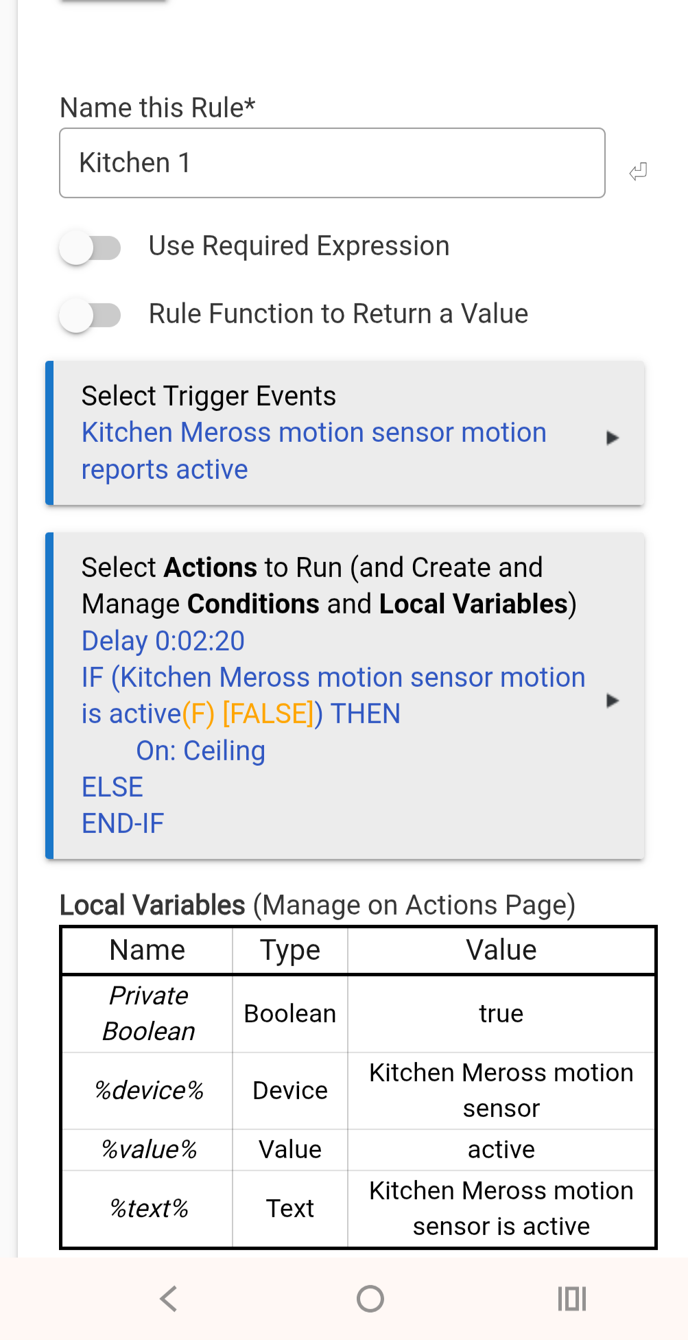

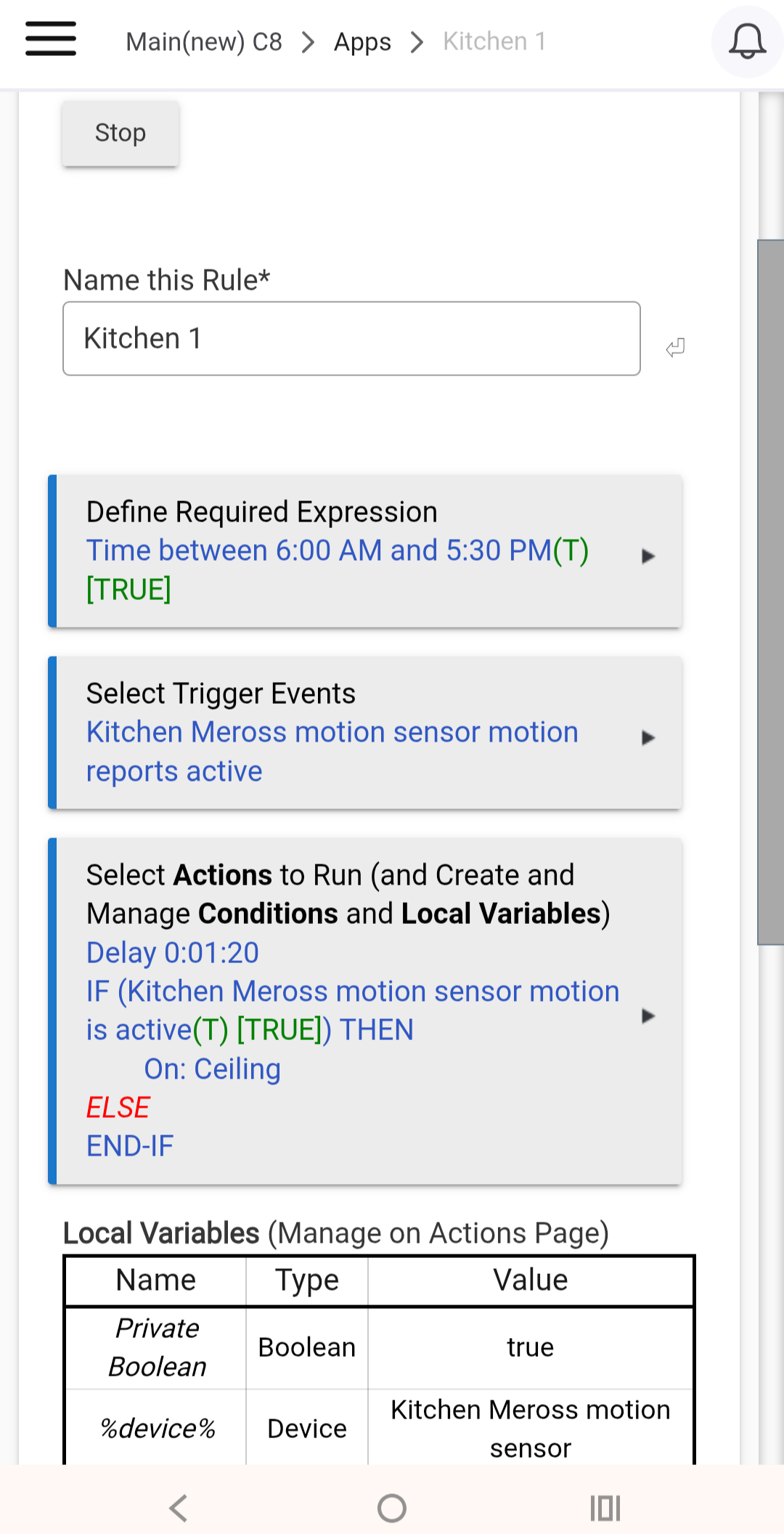

I must have this wrong. The light turns on after 2 minutes
I want to be able to walk through the room without the lights coming on. But if I stay in the room it comes on and stays on untill I leave the room not stay off.
Maybe this?
Trigger - motion active
Actions:
Delay 2:00
If motion active, turn on lights
The Delay should prevent retriggering within the 2 minutes.

I set the absence confirmation time down to 20 seconds. On the normal routine when I enter the room light go on, leaving now go off after about 24 seconds.
The new routine when I enter the light stays off and leave before the 2 minutes. After the 2 minute wait in rule light still comes on.

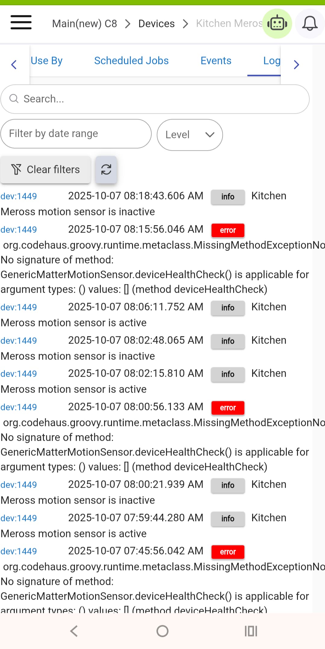

Change the logging to all triggers, events, and actions.
Enable logging on sensor and light.
Then post image of logs so we can really see what is happening.
(By the way, the rule should NOT be triggered if you leave in less than 100 seconds. [2 minutes less 20 second cooldown.]
Set the trigger to 140 seconds if “2 minutes” is important.)
Those log entries are coming from the device.
And they’re probably not actually relevant to your question about how to configure your rule. Even though there is an error.
Post the logs for the rule you have created.

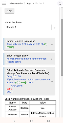

I think I have it. Seems to be working

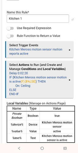

It's probably not doing anything bad, but since it's not being used, remove that ELSE.
I believe I've tried it without the else and the light came back on
That's a coincidence. There's no action associated with that ELSE, so it's not doing anything or otherwise somehow influencing anything.
I suggest that you go back to @Sebastien version and show us all the logs from one trip through the room.
Maybe then we can provide some insight.
As @hydro311 mentioned, the "ELSE" isn't causing the light to come back on (or do anything at all since there are no actions in it). However, I see an un-cancelled "Delay," which means it will still be there when (and after) the rule re-triggers, so that's probably what's doing it -- but I wouldn't really troubleshoot this version of your rule much more.
I agree that your original rule was best and would second the suggestion to return to that, re-enable all logging for the rule if you turned it off, and then share those logs here to see what might be going on.

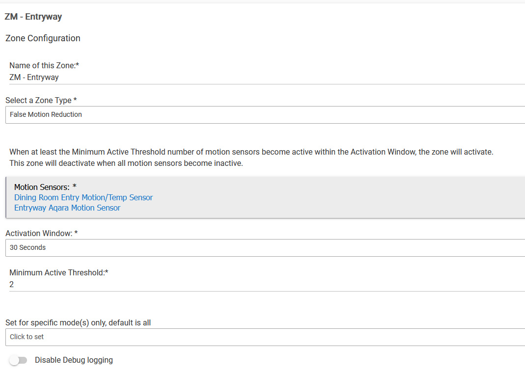

I didn't read the thread completely so I apologize if someone else spoke about this - I find that two sensors works better for me - with Zone Motion app. I mention this idea as all my motion sensors seem to have different periods - once activated. so if one is active - and motion occurs again during that window you won't get a second activation. with two sensors, it's much easier to validate room occupancy.
with a 2 min activation window (mine is actually 30 seconds) I'm able to achieve my desires
This is the routine I'm using and it seems to work.
