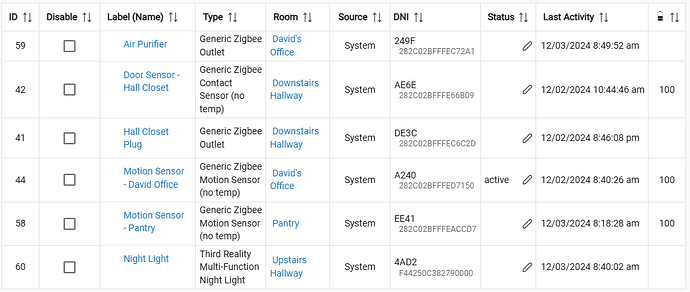

Here is a screenshot of my devices:

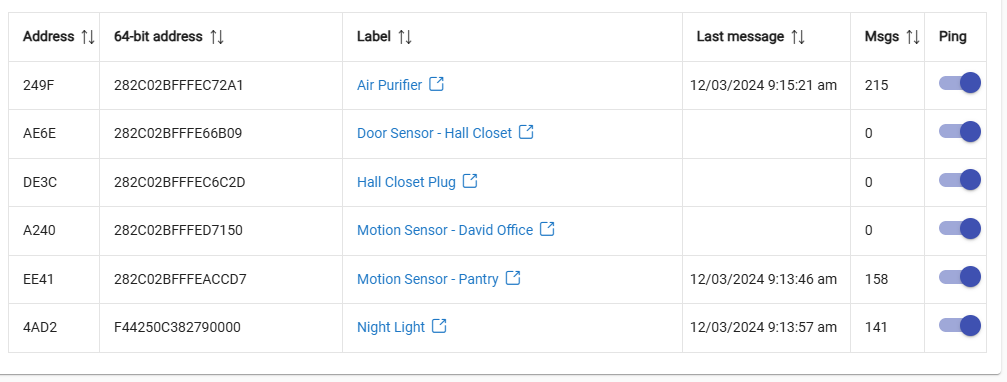

Same list under Zigbee Details - The "Msgs" for each non-working device = 0:

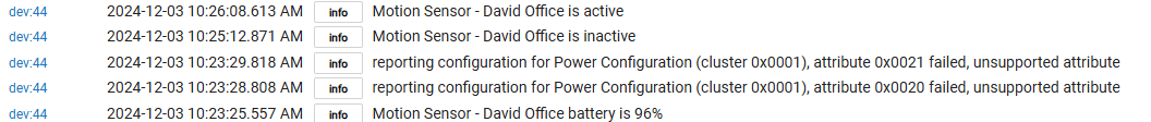

This seemed to have worked, but I did get some Power Configuration failures.

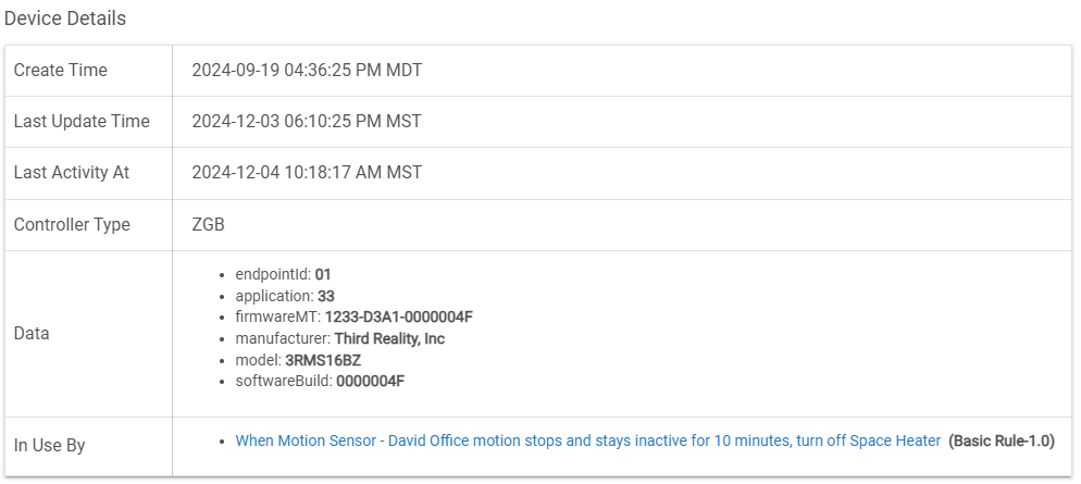

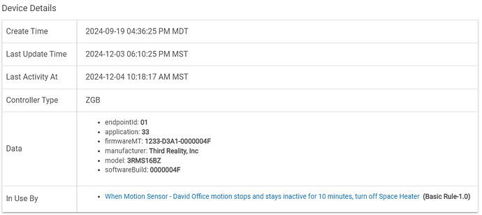

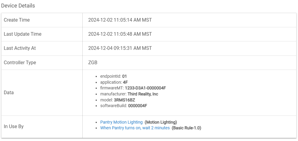

I am not sure if this is the info you are after? Firmware? Software Build?
  • endpointId: 01
  • application: 33
  • firmwareMT: 1233-D3A1-00000033
  • manufacturer: Third Reality, Inc
  • model: 3RMS16BZ
  • softwareBuild: 00000033

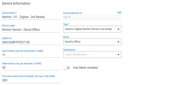

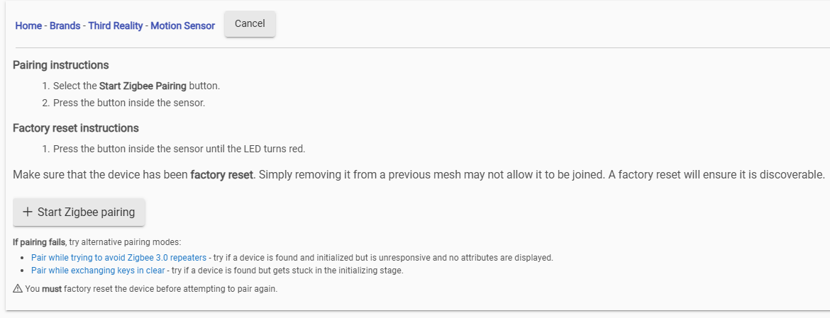

This is how it was installed:
Nothing in these menus seem to be relevant to the sensor:

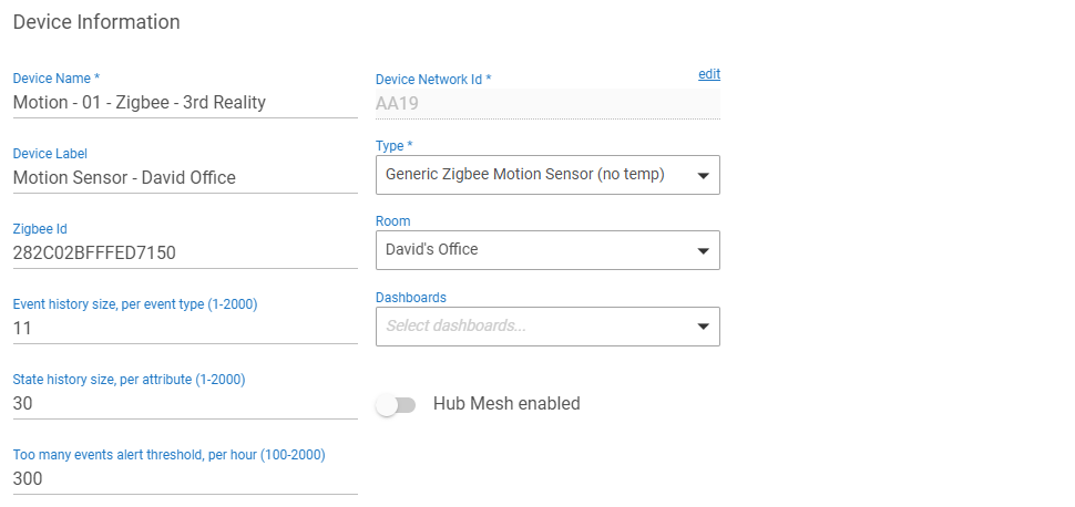

Driver, known as "Type" on the device's details page in the device info section...looks something like this:
I unplugged for a few minutes, and no changes.
As for drivers:
I have a good outlet and a good motion sensor up an running on these drivers, which are the same drivers I am using for the bad outlet and motion sensor.

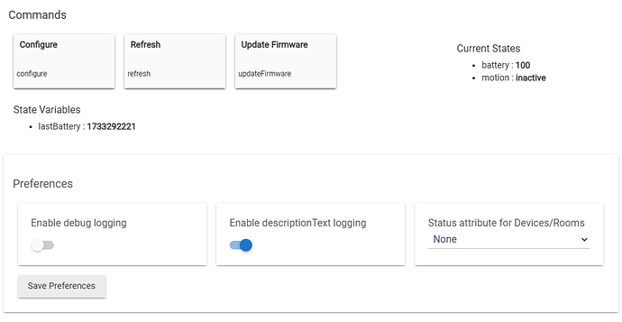

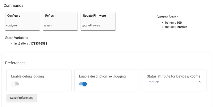

So in terms of "bad" devices you're referring to the power config log messages, but the devices do respond to control from their Device pages, correct?

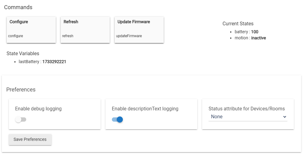

Can you post a screen shot of one of the devices that is not showing the power config log messages, and of one of the devices that is showing that message? The top section of the device page, and the Prefernces section below it.
Sorry that I wasn't clear, I had only re-joined one of the devices at that point, so the two other were still misbehaving.

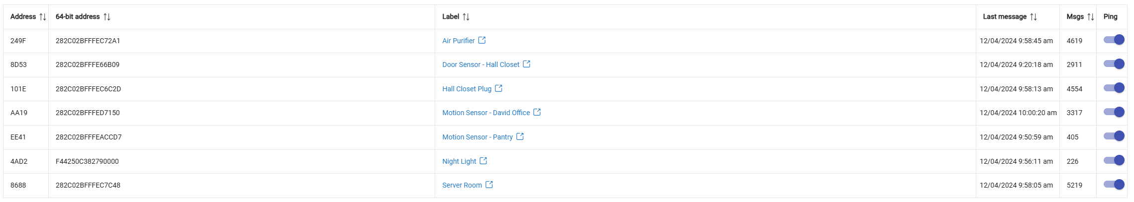

This is where we are this morning:
Below are all the Zigbee devices I have now, and they seem to all be interactive with the hub, as there are messages from this morning for each device. However, the getChildAndRouteInfo page still does not list two, what I believe should be, child devices: The "Door Sensor - Hall Closet" (8D53) and "Motion Sensor - David Office" (AA19).
I am not sure what I am troubleshooting at this point, as all devices seem to be functioning properly. It's just that the getChildAndRouteInfo seems to not describe what's actually detected under the "Zigbee Details" screen.

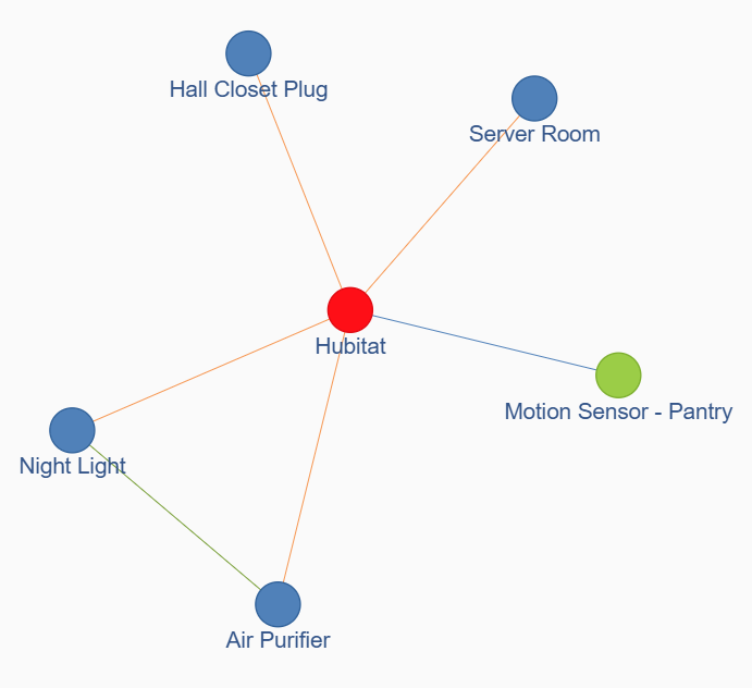

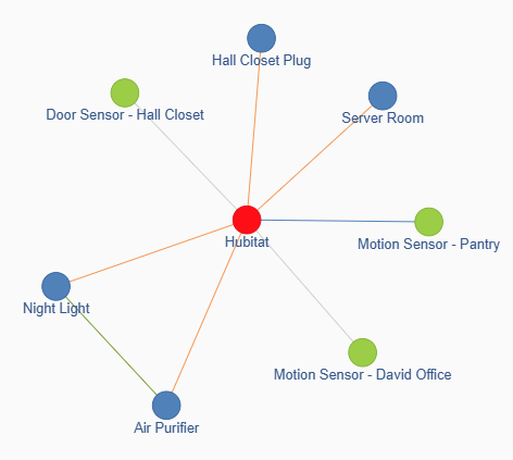

I know, I know...the device graph should not be trusted! However, for one brief second, it showed this:
Though, 99% of the time, it shows this, with the "Door Sensor - Hall Closet" (8D53) and "Motion Sensor - David Office" (AA19) missing, which is in agreement with getChildAndRouteInfo. One thing of note. The "Door Sensor - Hall Closet, 8D53" and "Hall Closet Plug, 101E" are like 4-5 feet from each other, with the HE hub being 15-20ft away, so it isn't obvious to me why the closet door sensor shouldn't route with the closet plug:
Motion sensor that was added after other devices went non-responsive. This one has always worked:
Motion sensor that was previously non-responsive:
I think you're done. :wink: Seriously, bold is what you were waiting for.
There are frequently gaps in what's reported depending on what tool/endpoint you're looking at. As long as things are working I would not worry about what's getting reported. :smiley:
