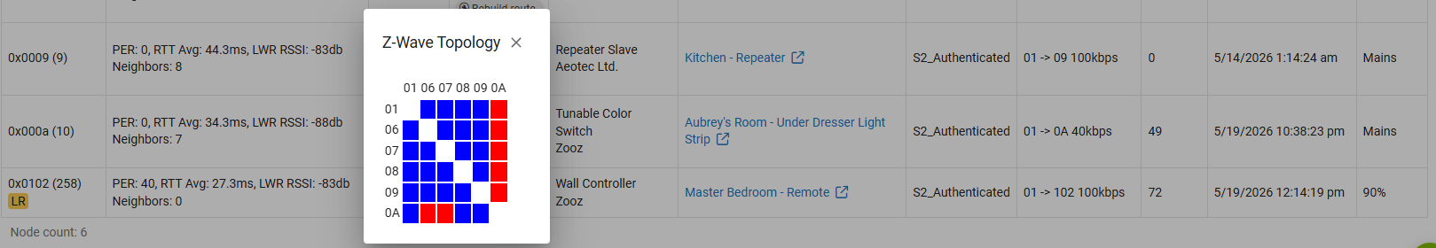

But when I include a new device, in the zwave topology map, the column for that device (so other devices ability to see the new device on the network) will be solid red... even for the hub. Which is weird too because the hub literally just included it.
But I get weirdly inconsistent behavior until after I reboot. After which the topology map looks fine and everything acts fine.
