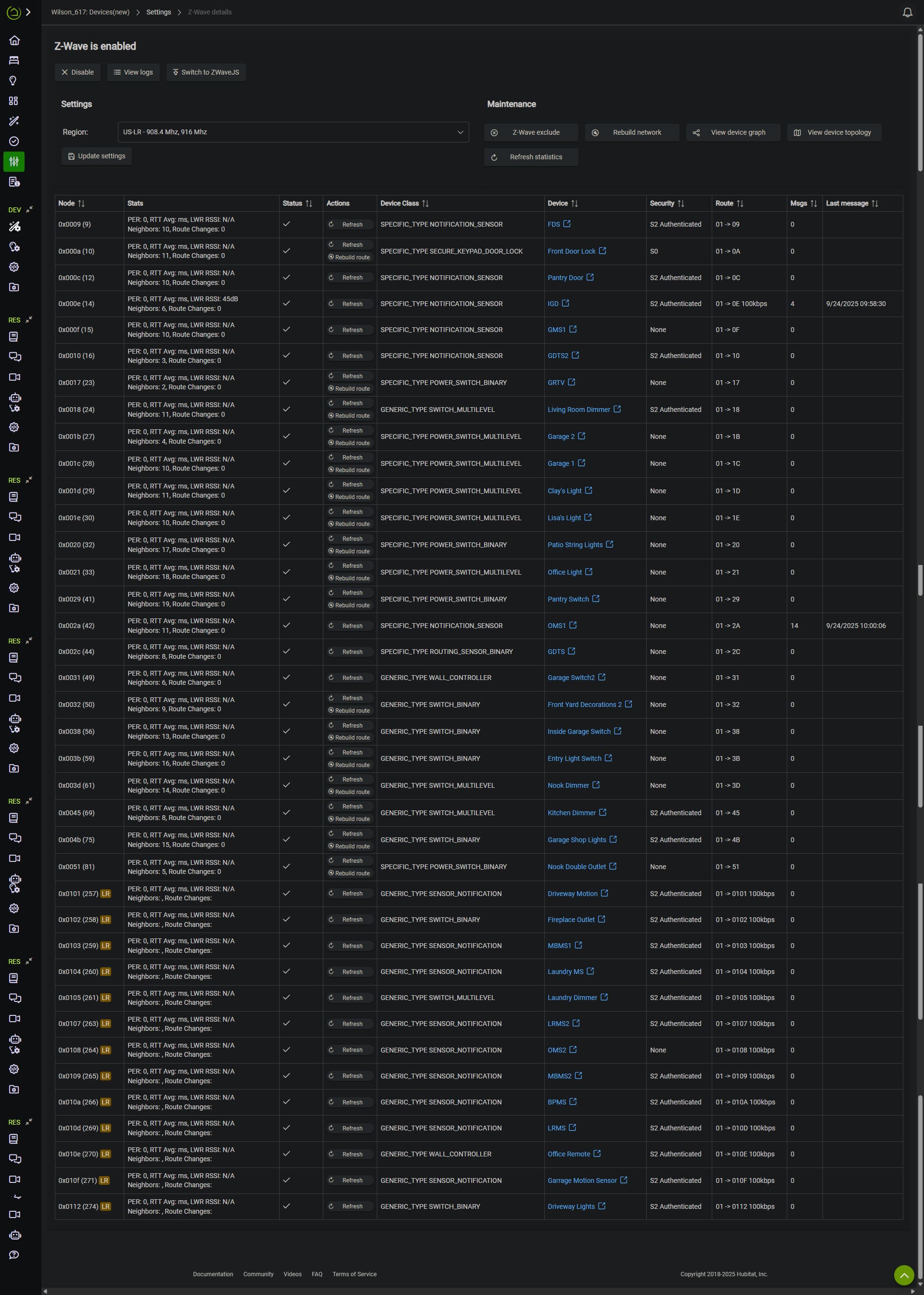

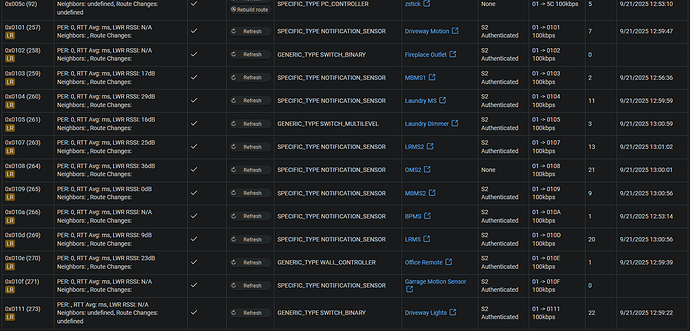

C8 (standard) . I have a Zooz Zen73 toggle switch I need to remove, It is non responsiove. I want to remove and reinclude it. I have tried the normal excusion process, nothing Happens. Before I go nuclear and do the Force Remove (I know its a bad idea), I was going to try the old ghost removal process. Problem is, it has a 3 digit device ID (as all of my 800LR devices do) , but the Zwave controller doesn't have any devices with 3 digts ID's. The device I need to remove is the last one, Driveway Lights device 273. Is there someother identifier to use withthe Zwave PC Controller ?

You're not going to see LR devices in a secondary controller. The topology of LR is such that it only communicates with a single other device/controller, your hub.
You'll have to try the typical, hub-based techniques for this. An LR "ghost" is unlikely to cause any problems, though, even if you cant remove it -- not like it's going to be a repeater. :slight_smile: (That's the usual explanation for problems.)

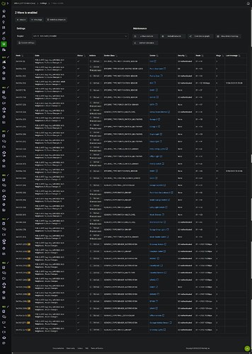

I went ahead and attempted another migration this morning. I would liek to say it looks promising, but in all honestly is looks just like the last three attempts where thiskn Look like they are happenign as they are supposed to, but the devices remained un responsive. I guess at this point its really just a waiting game .
Here is waht everythig looked like whenthe hub rebooted from migration. Not the donor hubwas completly shut down before I began this migration .
Summary
logs prior to2025-09-24 09:52:23.446 AM are before the migration
So far the only devics showing in the regular logs are matter devices no Zwave devices areee showing any activity . This is consistatn with past experience.
No Zwave activty has been logged since 2025-09-24 11:19:01.974 AM
